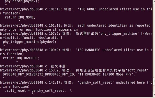

The below Linux Driver of Ethernet PHY is above Linux 4.
And our customer used the Linux 3.10 and found that it has no definition of genphy_soft_reset. So do we have the linux 3.10 driver for reference?

Hi Kailyn,
If you can use the DP83822 linux driver, which has been more recently updated, it should contain the necessary information to fix this small bug. Let me know if you have any troubles with this!

Hi Kailyn,
Oh, sorry. I guess I wasn't clear enough. I was recommend referencing the DP83822 driver in order to copy over the missing / incorrect terms objects! The DP83822 driver is more up-to-date then the DP83848, so I was suggesting that the faster way to fix the bug is to search for the terms that toggle errors in the 822 driver and add those definitions to the 848 driver! Does that make sense?
