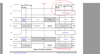

It is mentioned in the TI TLIN1028-Q1 datasheet OCTOBER 2020 SLLSEX4A – AUGUST 2019 – REVISED OCTOBER 2020 that there is a delay and an indeterminate state for the RxD:
We want to put a delay in SW to pass over this indeterminate state, though it's not clear what is the value for this delay. We are interested only in the transition delay from standby mode to normal mode. In the device switching characteristics it's mentioned:
Two times the Tmode_change but none seems to be the delay from the standby state, EN set to high to normal mode. Also all 3 them point to 8-15, though the transition from sleep to normal is in 8-16.
From the 8-15 it seems that the delay for this RxD Indeterminate Ignore has a value of:
tMODE_CHANGE (tEN included) + tNOMINT
Can you please provide us with the value for this mode transition delay, from standby state after pulling the EN pin to 1 to normal mode ? while the RxD is in this indeterminate state.
