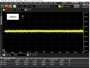

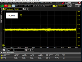

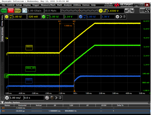

The following is the power waveform of each of the normal operation and the abnormal operation.
VDD33
Normal operation                                                                   Abnormal operation
VDDA_3P3
VDD11

  • Hello Brian,
    Thank you for your support comments.

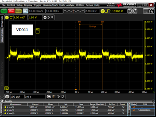

    When I checked the power supply, I found that noise did not occur when I changed rise time of VDD11.
    Specifically, the soft start constant of the VDD11 power device was changed to shorten rise time.
    The waveforms before and after the change are shown below.
    Is there a limit to the power startup time?
    Do the three types of power supplies need to have the same slope for power rise?
    Power rise waveform before change.
    Power rise waveform after change.
  • so the 2nd waveform fixed the issue? We don't have ramp time spec yet.
    Can you just change delay between VDD11 and 3.3V and see any impact?
  • Hi Brian,
    Yes. The problem was fixed in the second waveform.
    => I changed the slope of the power rise of VDD11. The result is a problem when the ramp time of VDD11 is long.

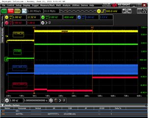

    The waveforms under normal conditions and the waveforms when problems occur are shown below.
    The cursor in the waveform is set to the minimum operating voltage.
    ①Normal condition (When no problem occurs)
    ②Waveform when a problem occurs Part 1
    ③Waveform when a problem occurs Part 2

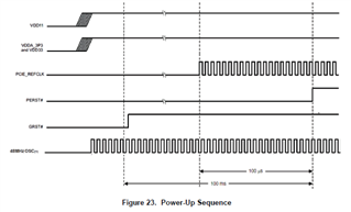

    1)
    In 9.1.1 Power-Up Sequence of the data sheet
    2. describes power-on, and 3. describes clock-on.
    Then, since there is a description of 2. 3., I think that it shows the order, but how about it?
    2)
    If there is no boot order of VDD11, VDD33, 48MHz in the answers so far, how is it guaranteed as the internal specification of the device?
    For example, if there is no boot order, will there be no current leakage at the other power terminal when one power is turned on?
    In addition, 48MHz uses a clock oscillator.
    I think that your evaluation board etc. uses a crystal units.
  • Hi Hisashi::
         Most important two items here:
    1: VDD11 must be early than VDD33.
    2:  GRST keeps low until power supply and clock oscillator or crystal stable.
        when clock is up a little early than power supply, leakage will be short and will not hurt device. What we need to avoid is clock is always on when power supply is off, which will hurt device.
    brian

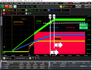

  • Hi Brian:
    Thank you for the important information.
    Let me ask you an additional question.

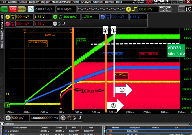

    a)
    Our power-on waveform is attached.
    Please comment on the startup procedure and power-on timing regarding the relationship between VDD11, VDD33, and 48MHz.
    Could you please show me the recommended timing for turning on the 48MHz clock?
    Green ・ ・ ・ VDD33
    Yellow ・ ・ ・ VDD11
    Red ・ ・ ・ 48MHz OSC
    b)
    Please tell me the answer of "VDD11 must be early than VDD33."
    The specifications of VDD11 and VDD33 are described in the data sheet
    As shown in the above waveform, is it okay if VDD11 starts up later than VDD33 starts up (rises from 0 [V])?
    Or does VDD33 need to start booting (rising from 0 [V]) after VDD11 has finished booting (0.99V or higher)?

    d)
    By the way, where can I find information on the power-on order in the data sheet?
    Yoda
  • a: what is blue signal XHCI_CLKIN_OE? can you capture GRST# in the same picture
    b: sorry, I'm confused with TUSB1310. For TUSB7340, VDD11 can be start late than VDD33. Pls. check  TUSB7340 EVM design.
    c: power supply is VDD11/VDD33. a little early means within 100us.
    d; you can find power on sequence on datasheet page 104
  • Hi Brian:
    Thank you for your answer.
    We will answer the questions you have received.
    a) Blue is not XHCI_CLKIN_OE. Blue was remeasured as GRST #.
    Green・・・VDD33
    Yellow・・・VDD11
    Red・・・GRST
    Blue・・・48MHz OSC
    Let me ask you again.
    e) Let me check the clock input timing.
    Is it necessary to input 48MHz after VDD11 and VDD33 are started as shown in the waveform below?
    See attached file(See white arrow)

  • a: waveform for a is good power on sequence.
    e: It's not necessary to move 48Mhz clock . If BLUE is GRST#, it should be low until CLK/power is stable.
    f: there should be protection diode inside between 1.1v and 3.3v to avoid leakage when one pwoer supply is on and the other is off.
  • Hi Brian:
    Thank you for your prompt reply.
    In the waveform of e), blue is not GRST #.
    About " It's not necessary to move 48Mhz clock."
    Is it possible for the TUSB7320 to be damaged or malfunction if 48MHz is repeatedly applied before VDD11 and VDD33?
    The intention of the confirmation is to confirm whether the 48MHz input timing must be after VDD33 and VDD11.
    Let me ask you again about f).
    Doesn't leakage current occur inside the TUSB7320?

  • Yoda:
        XI pin is not  failsafe, if 48MHz is repeatedly applied on XI before VDD11 and VDD33. ESD cell of XI pin could be damaged. So I suggested not longer than 100us before VDD11 and VDD33 is power up.
        for F, leakage current should not occur inside TUSB7320.
       For E, what signal is blue one?

  • Hi Brian:
    I understand the 48MHz input.
    Please tell me about the CLK output timing that does not damage the XI terminal.
    Which of the following waveforms does it correspond to?
    (1) VDD33 is 3.3V output state
    (2) 3.0V output state, which is the minimum value of VDD33
    Until now, I have been inquiring about the power supply (VDD11, VDD33) and the input of 48MHz, but I have not been able to get an answer. Can you tell me the reason?
    Was there a difference in the recognition of a clock oscillator and a crystal units?
    About "for F, leakage current should not occur inside TUSB7320."
    Is it necessary to support with the peripheral circuit of TUSB7320?
    About "For E, what signal is blue one?"
    This is the waveform supplied to the 48MHz enable pin.
    The resistance is divided by the VDD33 power supply.
    Yoda
  • Yoda:
        To not damage XI, the earlist 48Mhz clock is 100us from location 2.
       Was there a difference in the recognition of a clock oscillator and a crystal units? Crystal is using internal oscillation circuit and will start working after power is on. clock oscillator could be external clock  and it can be on Xi pin before power is on.
        For 48Mhx CLK enable pin, you can add a cap to delay the signal.
        About "for F, leakage current should not occur inside TUSB7320.", there is no special requirement for peripheral circuit.
    Brian
