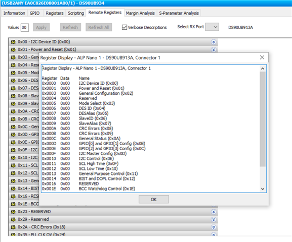

I’m using a camera with TI933 serializer and trying to connect it to 954 deserializer,
when I connect the camera to the 954evm evaluation board, the Analog launchPAD can not detect the 933 serializer address , please see the image:

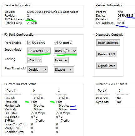

The 954evm configured with the following setting to be compatible with the camera:
POC voltage = 12 v
I2c voltage =3.3 v
Mode: Raw12/HF

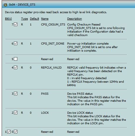

And the 0x04 (device status) register does not show any errors:
But the ALP does not detect the address of the 933 serializer and does not allow me to update the values of any register in the 933 serializer (in the camera)
Any idea or suggestion to solve this please?
