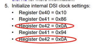

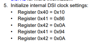

  • Hello Casey
    WriteI2C (0x40,0x10);
    WriteI2C (0x41,0x86);
    WriteI2C (0x42,0x0a);
    WriteI2C (0x41,0x94);
    WriteI2C (0x42,0x30)
    WriteI2C (0x01,0x00); //Enable DSI
    The 0x42 register cannot write 5.  The 0x42 register cannot write 5. After writing the 0x42 register, read the 0x42 register with a value of 0
    add patern ,A screen displays color bars. Nothing else is shown.

  • Hello gj,
    The 0x40-0x42 register sequence is writing to indirect registers within the device. The readback of indirect registers is controlled with bit 0 of the 0x40 registers when you select the indirect page. So with a setting 0x40 = 0x10, then you will be able to write the indirect register, but with a setting of 0x40 = 0x11, then you can read OR write the register.
    So from the sound of it, it seems you are able to display PATGEN with internal clock and internal timing so far, but are not able to display the SoC video source?
    Please continue with this debug flow chart from the app note I linked before:
    So far it looks like you have made it to the red mark. Please continue along this flow chart and let me know where you are getting stuck
    Casey
  • Hello gj,
    The 0x40-0x42 registers sequence is writing to indirect registers within the device. The readback of indirect registers is controlled with bit 0 of the 0x40 registers when you select the indirect page. So with a setting of 0x40 = 0x10 you can write the indirect registers, but with a setting of 0x40 = 0x11 for example you can read OR write the indirect register.
    Please continue with this debug flow chart from the app note that I linked before:
    So far it looks like you have made it to the red mark. Please continue along this flow chart and let me know where you are getting stuck.
    Casey
