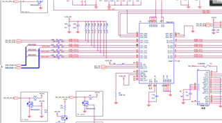

Hi David,
1. I referred Bitec FMC Card schematics with TMDS181 used for Sink interface. I observed 50ohm resistor connector at the output side. Can you please let me know whether these resistors are mandatory and significance of these resistors. Attached is the image of schematics of the same card.
2. Also can you confirm that the IC can be powered using VDD=1.15V
Hi.
1. It looks like the device connected to the TMDS181 requires its input to be AC coupled (C31-C38). The TMDS181 follows the HDMI 1.4b and HDMI2.0 standards which define a DC-coupled 3.3 V common mode interface. So the external 50ohm termination to 3.3V mimics a sink termination and set the common mode voltage to 3.3V. Please note the 50ohm termination produces a double termination network and reduce the output signal amplitude so you have to lower the TMDS181 VSADJ resistor to compensate for the signal amplitude drop.
2. Please refer to section 6.3 of the TMDS181 datasheet, minimum VDD is 1.1V. So 1.15V is still within the TMDS181 recommended operating condition.
