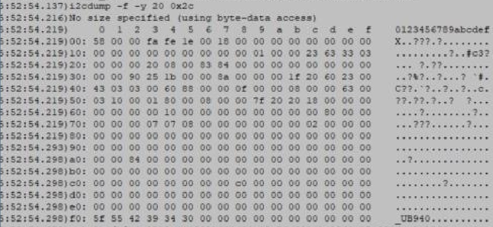

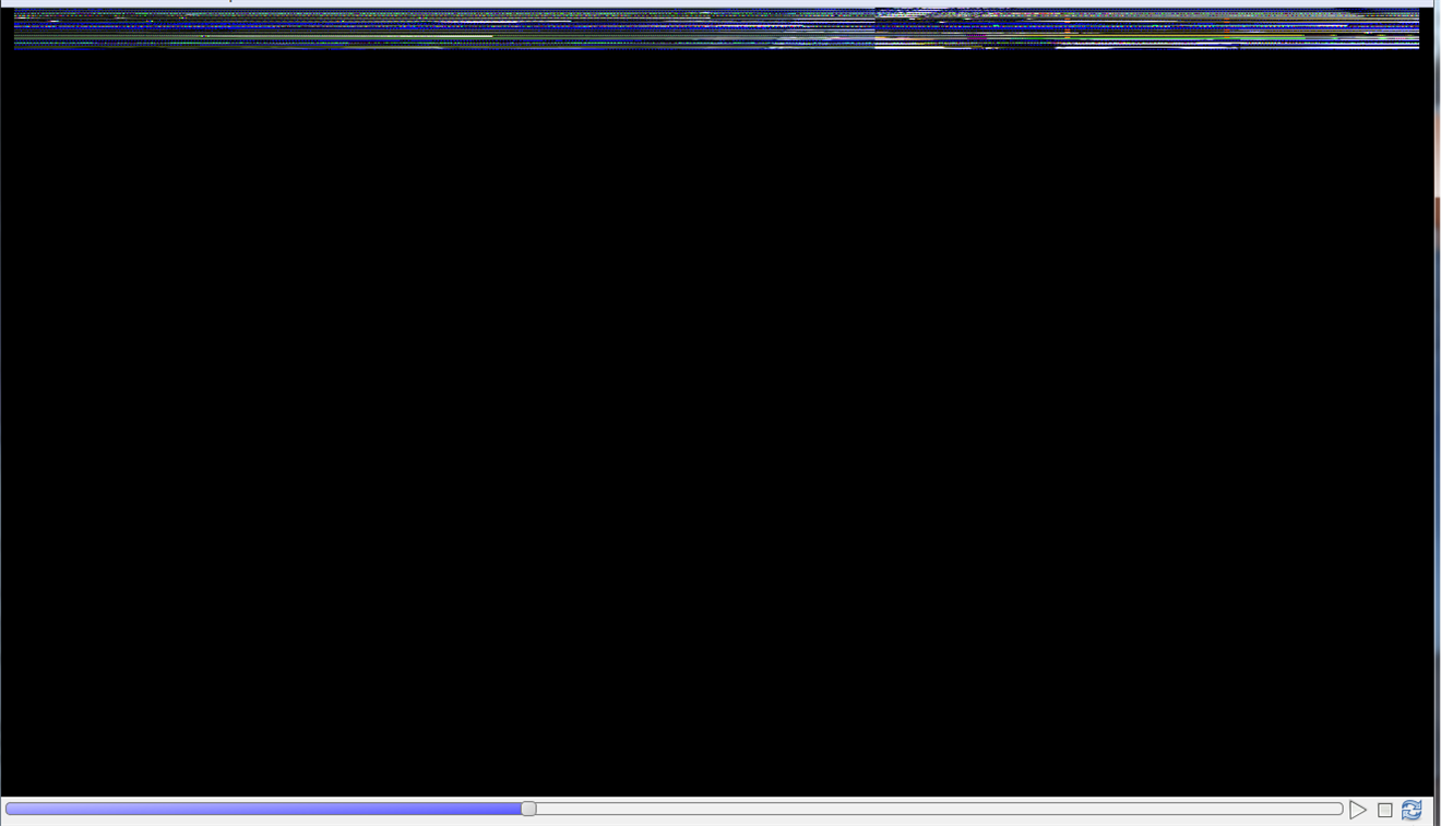

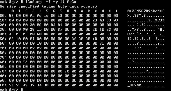

customer use DS90UB940-Q1, found have display issue. we check the normal and abnormal regest, only have below differences, can you help give some comments?
I found the reg 0x1D is difference, normal is 0x42, abnormal is 0x63, is it problems? what's the meaning of reg0x59 and reg0x60  ?
does the 940 have errata about this issue? how about 940N? thank you
the normal reg value:
the abnormal reg value:
difference between normal and abnormal:
issue picure:

    Can you dump the indirect registers, from 0x00 to 0x2F ?
    - 0x1D -- normal is using the old device (940), abnormal is using the new device (940N)
    - 0x3b -- AEQ status, 0x00 is a good value, but 0x1F is a bit too high which means there may be a link issue.
    - 0x59 -- Internal use only
    - 0x6D -- The value written to the Indirect register address shown in reg 0x6C
    - 0xa0 -- This register is not used
