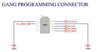

Could you please tell me the reference of the J14 connector on LAUNCHCC3235MOD? I could not find it in the BOM.
BR,
Brahim
  • Brahim,
    J14 is not a component. It is a footprint for Tag Connectors.

  • Hi Seong,
    Where I can find this footprint ? what component to use for the layout (schematic and footprint)?
    BR,
    Brahim
  • Brahim,
    I am unable to share the symbol and footprint from our database, but I did a quick google search and was able to find this: https://www.snapeda.com/parts/TC2050-IDC/Tag-Connect%20LLC/view-part/
    See if this will work for you.
    BR,
    Seong

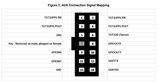

  • Hi Seong,
    Will this connector of 10 pins work with XDS110 debug probe that has a port of 14 pins?
    BR,
    Brahim
  • Brahim,
    What is your goal? Based on this thread and your other one here, it seems like you have a XDS110 debug probe and a tag connector. And you want to directly program the SPI serial flash that is internal to the module.
    From the image Figure 3 that you share in your previous post, there are only JTAG and UART signals, so you will not be able to program the SPI serial flash with this. Instead, you will need to use a SPI programmer.
    With the equipment that you have, I recommend you use UART to program your module using UniFlash. This means you'll need to connect to the module pins 46 and 47. Ensure there are 100k pull up resistors tied to these pins.
