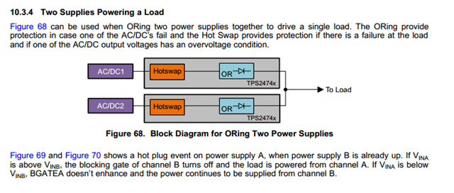

TPS24741: Two power input to one load output
Part Number: TPS24741
Hi team,
My customers want to use 2pcs TPS24741 in below application, two PSU inputs, one load output
But they have a concern that considering their high-power application (140A current), two TPS24741 branches may switch repeatedly, causing unstable output voltage. I drew a picture for your reference:
Could you share your comments on this? Any method to solve the issue?
