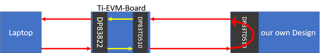

I am having issues getting a proper link over Single Pair Ethernet with the Ti EVM-Board and our own design.
The current setup is:
- Laptop connected over LAN-Cable to the DP83TD510E-EVM Board
- Twisted pair of copper (~10cm) connected to the EVM-Board and our own Board. Our own Board features also a DP83TD510E, with a 50Mhz oszillator.
- The DP83TD510E on our Board is then set to "Reverse Loopback" (Register 0016 set to 0110) to send the received data back over SPE to the EVM-Board.

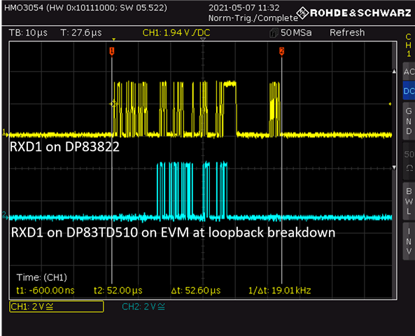

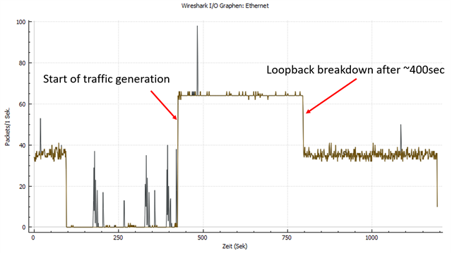

In the first ~400-500 seconds the loopback works flawlessly. But for no reason, after a sertain time no more incoming packets are recorded. The duration of the loopback working is approx. always the same. In the picture below you can see ~64Hz in- & outgoing packet rate, and after the breakdown it drops to 32Hz, which means no more packets are received.
When the loopback is working properly, the RXD0 and RXD1 signals on the EVM-Board of the DP83TD510E look very consistent. When the loopback breaksdown the RXD0 and RXD1 signals tend to be not consistent at all. In the picture below is a example of the signal after loopback breakdown, looks like a part of the packet is missing.

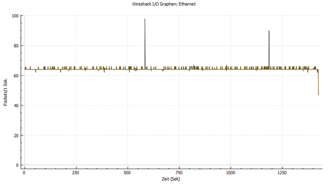

    I made some loopback tests just with the EVM board. They all worked fine. The analog loopback (register 0x15 set to 0x108) on the EVM worked fine, as you can see in the picture below (same Datarate as above, expectet packet rate is 64Hz):

    the packets are generated using the programm called packetsender from packetsender.com . With the build-in UDP traffic generator it generates packets with a frequency of 32Hz, i figured out that the breakdown does not depend on the packet-frequency.
    The DP83TD510E on our board is set to reverse loopback to return all received data back over SPE to the Ti-EVM. Packets received from the laptop are logged with wireshark.

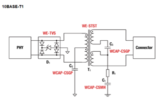

    Regarding the analog frontend we went with the solution from Würth: https://www.we-online.com/web/en/electronic_components/produkte_pb/produktinnovationen/mlcc_1.php
    If you can have a look on our schematics we would appreciate that. Let me know how we can arrange that!
