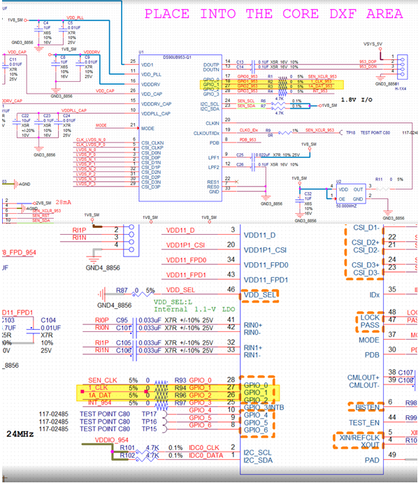

We found the below situations.
  1. Clock : From Soc --> 954 --> 953 --> Dmic (Digital microphone),
can transfer, but clock became slow.
  1. Data: From Dmic --> 953  -> 954  --> Soc:
954 can't get 953 data.
Please help to check the following code for assigning GPIO register . Thanks!
Could you guide us how to resolve this issue?

  • Hi Jimmy,
    Could you provide a bit more information? The configurations for the registers seem ok, so I would like to explore if there are any other issues.
    1) Are you able to probe the GPIO output pins on the 953 and 954, to get a signal?
    2) It may also be a bandwidth issue, so could you let me know what the throughput of your system is?
    There is also an App Note on the 954 Datasheet website, which can be referenced for use of I2S over the forward and back channel (SNLA314A) in the 953/954 setup.
