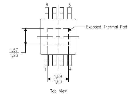

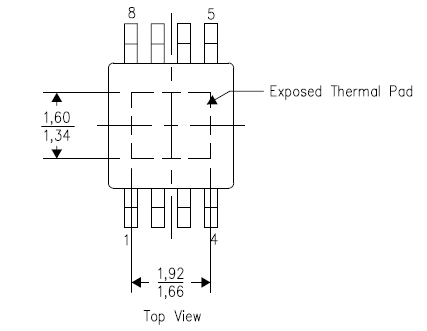

Regarding to thermal pad on TPS2001C, my customer have a question.
It is described on page 37 and page 39 but each dimensions is different.
Which the dimension should we refer?
Tao_2199
That is different package one is DGN(S-PDSO-G8) anthor is DGN(R-PDSO-G8).
