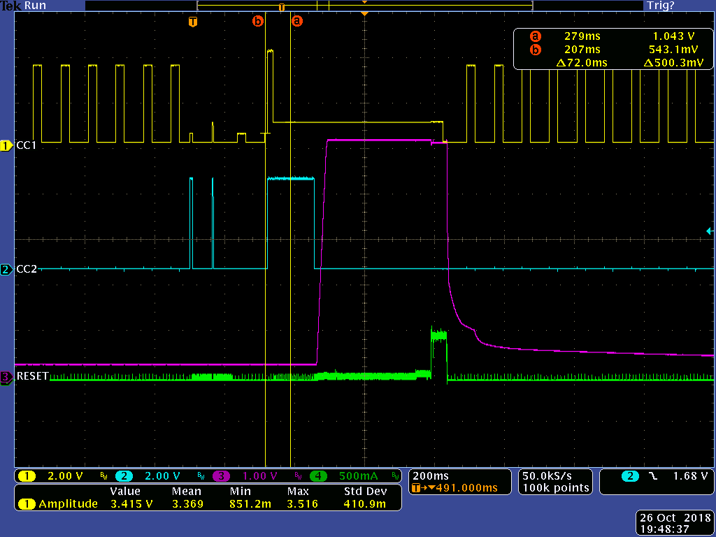

It appears that when the CVS is pulling down the CC1 with Rd with CC2 open the TI TUSB320LAI side is reported by the CVS as having a lot of activity on the CC lines.
Attached is a Word file with a scope capture of a connect of a TUSB320RWBR on an EVM to the TUSB320LAI that is on our device.
The setup is the TUSB320 EVM board REV B configured by dip switches as a DFP connected to the DUT with a TUSB320LAI configured as a UFP with GPIO by pulling the port pin to ground as shown in the schematic segment below. The TUSB320 EVM has a I2C to USB converter attached that is driven by a PC. The test in the first scope capture shows a test where the TUSB320 EVM is commanded via I2C from UFP mode to DFP mode and attaches to the DUT and then changes Rp to set the three current set points.
As can be seen the CC1 trace has pulses on it caused by the TUSB320LAI on the DUT. These pulses are causing the 4.3.4 USB-IF test to fail for Rp not being constant (See captured protocol suite screen capture in the document). It is interesting to note that the TUSB320RWBR chip does not do this when substituted as DUT and it appears that it would pass the test.
Left to Right: First two graticules have CC1 pulsing with a Default USB Current Rp originating from the DUT’s TUSB320LAI. Graticule 3 is the transition from UFP to DFP of the TUSB320 EVM. 8 through 10 are the tests for TD 4.10.1. Yellow – CC1, Magenta - CC2, Cyan – VBUS, Green VBUS current.
It would appear that there is either a design issue with the TUSB320LAI or that it is performing a function that I am unaware of for UFP only operation and my VIF is incorrect.

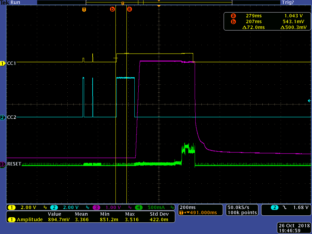

    Below are scope captures of the TUSB320LAI and then the TUSB320.
    I believe that the thing that is causing the failures is that blip on CC1 to the left of cursor b that shouldn't be there if the TUSB320LAI only presented Rd in UFP mode as advertised in the datasheet. It appears that the TUSB320LAI is defaulting to DRP if the CVS presents as a SNK even though it is not in DRP mode.
    This test is a TUSB320 EVM being used as a CVS connected to our devices, one with the TUSB320LAI and the other with the TUSB320.  On the CVS surrogate I first disable the Rp / Rd for half a second and then I enable SRC for 5ms then SNK for 30ms then SRC for 20ms then SNK for 150mS and then finally SRC for 200 then disable the Rp / Rd.
    There are a few things that don't make sense about the timing in this test, I think that because I reset the state machine to get the device to disconnect and change from DFP to UFP some of the timing is off.

  • Hi Don,
    I'm glad that the TUSB320 worked! I do not have your complete system setup here in my lab, so I the best comparison I can have is a passing/failing result with the LeCroy analyzer. I want to be sure that your working system corresponds to a passing LeCroy test, so then I can work towards reproducing this issue and then finding a possible fix. Can we get the data for LeCroy CVS -> TUSB320 -> Device?
    As Mike mentioned, the pulses could be caused by Audio Accessory detection, please try disabling this feature and see if the pulses go away.
  • Nicholaus and Michael,
    That was it.
    Setting BIT 0 in register 0x09 stopped the pulsing.
    Here is how I got wrapped around the axel:
    I am designing a product that is a simple UFP.  I chose the TUSB320LAI because it was newer and cheaper.  We are using the GPIO functionality so that charge rates can be set while the unit is off.  Reading the datasheet I went by the paragraph below:
