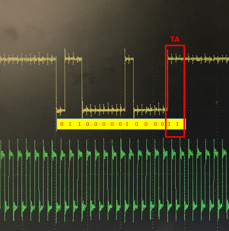

Part Number: DP83848I
Hello E2E,
The TA-bits of DP83848I are not indicate 0x10 in our circuit board for test.
Please tell me what caused it.
MDC and MDIO patterns are verry short, therefor I think that parasited capacitanse is nire null.
BR,

Hi ACGUY,
If there are multiple PHYs on the same MDIO bus with each PHY having a 1.5kohm resistor then all the pull ups will be in parallel and the total pull will be too strong.
