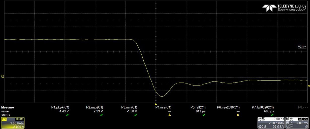

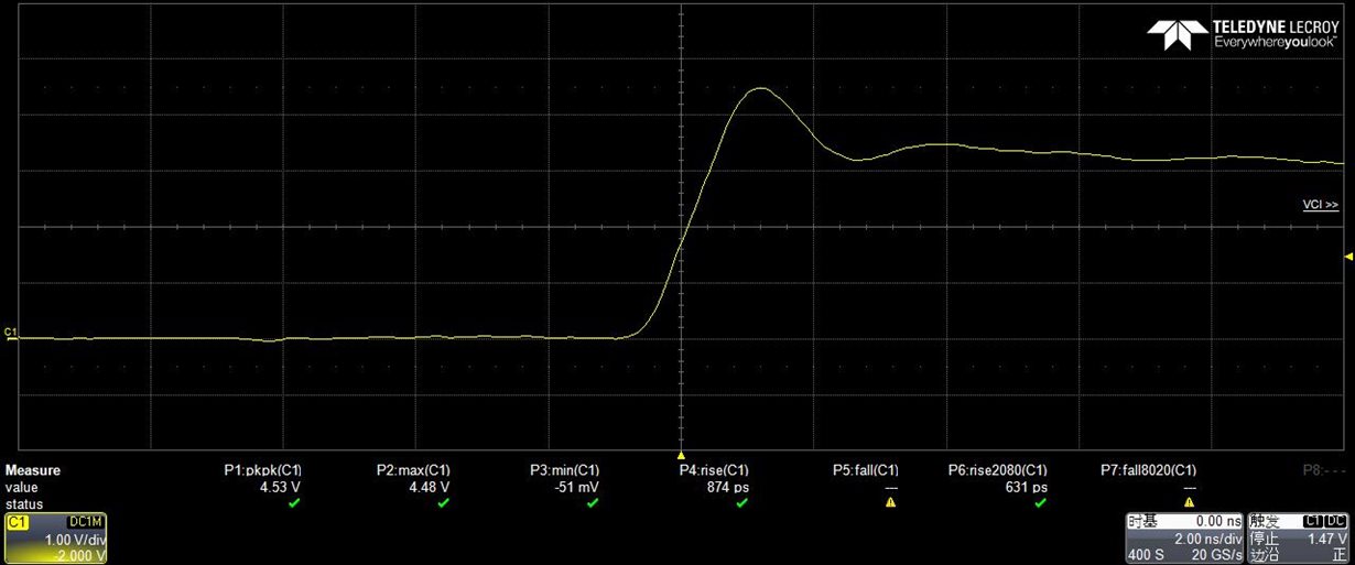

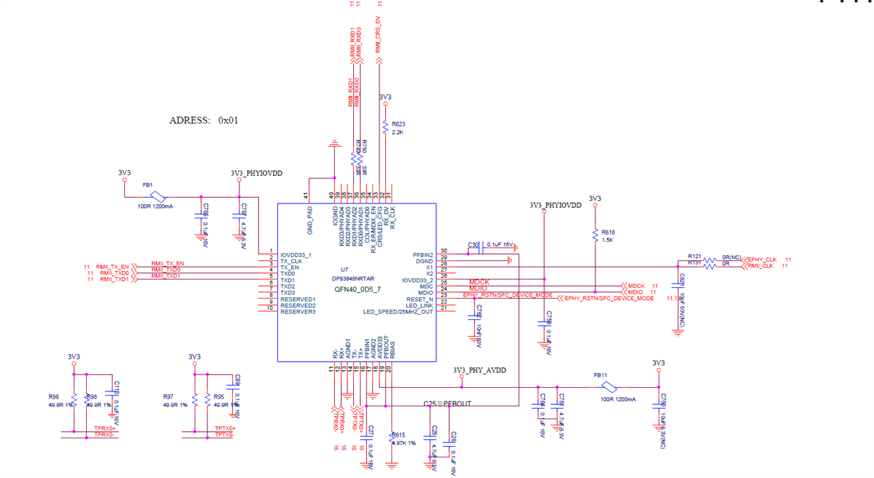

Ours customer who used DP83848NRTAR met a question about the CRS_DV signal。He tested at the CPU side and the overshoot &undershoot is  big,  the highest level got to 4.5V and the lowest level was -1.5V.  Below is the schematic and waveform, he wanted to know if he could use the software to improve it.
