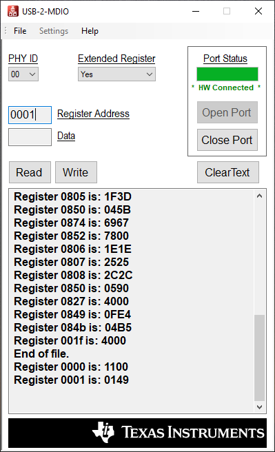

Then I connect the USB-2-MDIO Tool and load the Script "AutoNegotiation_Initialization.txt" to both boards (PHY ID 0)
After that, one LED D15 stays on (see picture attached). So the 1.st partner cannot establish the link to DP83822.

    The steps you have followed appear correct. Can you verify that you are able to read/write registers with the USB-2-MDIO tool? Reading register 0x0000 or 0x0001 as an example?

  • Hi Justin,
    thanks for the fast response!
    I configured both boards again with the script AutoNegotiation_Initialization.txt.
    I can read out both registers (0000 is always 1100, 0001 is 0149 after writing the script, and 016D after re-connecting the USB):
    These values are the same for both boards.
    My issue remains, connecting board 1 to the communication partner, everything seems to be OK (D15 off - link established):
    For board 0 the LED D15 stays always on, and the com partner couldn't establish a link to the DP83822:
    So is the conclusion that the hardware from board 0 might be faulty?
    Tommy
