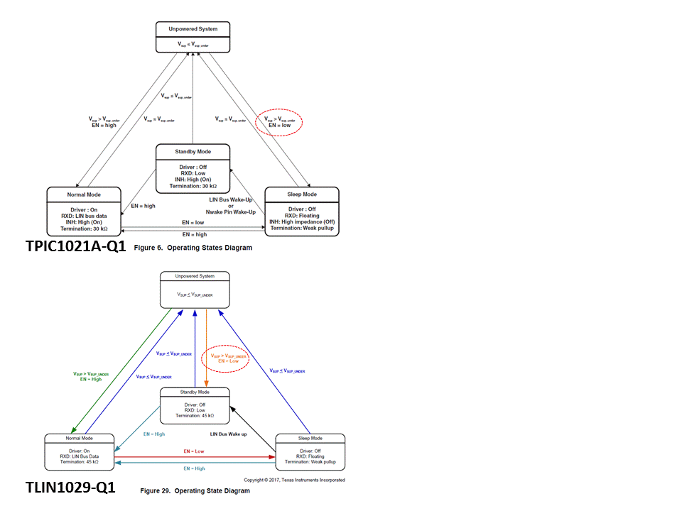

Hi team,
As to TPIC1021A-Q1, transition is made from unpowered system state to sleep mode
in the conditions of VSUP > VSUP_UNDER and EN = Low.
But as to TLIN1029-Q1, the transition is made from unpowered system state to standby mode.
Please see the figures below.
My customer wants to know the reason why the transition destination was changed.
Please let me know.
