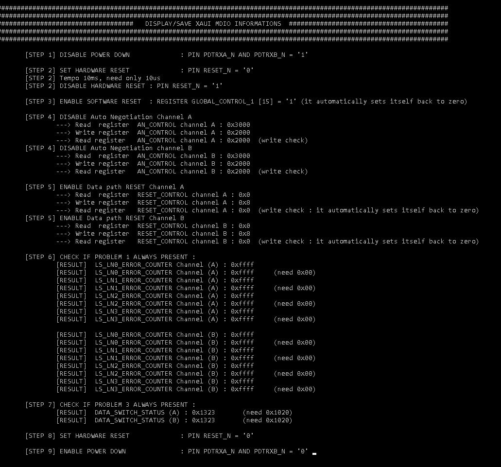

PROBLEM 1 :
Some COR (Clear-On-Read) Register never pass to '0' when I read it.
For example LS_LN0_ERROR_COUNTERLS_LN1_ERROR_COUNTERLS_LN2_ERROR_COUNTER and LS_LN3_ERROR_COUNTER.
I don't try to test all COR Registers but these 4 registers never pass to 0 when i read it. I saw this problem when i tried to use test pattern.
Each time i read it value = default register = 0xFFFD.
PROBLEM 2 :
It's the biggest problem because i cannot use LS side.
Register LS_SERDES_CONTROL_2 always equal to 0. I tried to write this register to default value 0xDC04 but when i read it again, value = 0.
I cannot change this register. In datasheet we can read that this register depend on PD_TRXx_N and LS_TX_ENRX register bit 1E.0001 bit 15.
In my configuration PD_TRXx_N = '1' (hardware check) and  LS_TX_ENRX register bit 1E.0001 bit 15 = '0' (Can be checked in .txt file).
PROBLEM 3 :  .
DATA_SWITCH_STATUS value = 0.  Default value is 0x1020.
Here it's impossible to have bit [15:12] = 0000 because it's not a possible value in datasheet. It's Read Only register so i cannot try to fixe this value.
If someone can help me?
Thanks.

  • Ok i found the solution of problem N°2 :
    The problem is on register LS_SERDES_CONTROL_1 bit 15:12 (LS_LN_CFG_EN[3:0])
    Read values in LS_SERDES_CONTROL_2 and LS_SERDES_CONTROL_3 and LS_CH_CONTROL_1 reflect the settings value for Lane selected through LS_LN_CFG_EN[3:0].
    But LS_LN_CFG_EN[3:0] = 1111 by default. It's not a possible value (similar to read register value of lane 0, 1 , 2 and 3 in the same register).
    If i use LS_LN_CFG_EN[3:0] = 0001 (To read Lane 0 settings,) , the value of register LS_SERDES_CONTROL_2 is 0xDC04 (default value) and not 0000.
    Nevertheless, problem N°1 et 3 are always presents. If someone can help me :

  • I use external MDIO data controller and not EVM with the USB Dongle Board.
    Problem 2 is the proof that we cannot read the default value noted in the datasheet just after a reset of the component.
    So it's impossible that your EVM GUI only reset component and after can read the value of the datasheet.

    You can find all access and result of the test.
    Up to now, i always reseted the component with a hardware reset. I add a software reset in step 3, but normally it change nothing.
    When i disable Auto Negotiation, results change but problems are always here.
    For problem N°1 :
    Before Auto Negotiation modification, i had all LS_COUNTER initiated to 0xFFFD (correct value) but register never pass to 0 after a read.
    Now, All LS_COUNTER are initiated @ 0xFFFF (no correct value) and register value never pass to 0 (can be see in step 6 ).
    For problem N°3 (step 7) :
    Before Auto Negotiation modification, DATA_SWITCH_STATUS register was = 0  (correct value 0x1020).
    Now DATA_SWITCH_STATUS register = 0x1323.  Seem to be better but it's not the correct value.  Differences seem to be about "ON / OFF condition indicator" but they don't have any information about that in datasheet.

    The problem N°3 is resolved. DATA_SWITCH_STATUS Register have RO/LH bit so we need to read two times the register.
    Now only problem 2 is present (cor register never read as null).
    About your questions :
    PLL are locked (read two times register CHANNEL_STATUS_1 : see result in attachment step 6).
    Problem only appear in LS_LNx_ERROR_COUNTER.
    Problem don't appear on Register HS_ERROR_COUNTER and KX_STATUS (step 9 in picture in attachment).
    I send (in attachment) the value of all register in the .txt file.

  • All registers are read twice in this test :
    CHANNEL_STATUS_1 (for lock), DATA_SWITCH_STATUS, KX_STATUS, HS_ERROR_COUNTER and LS_LNx_ERROR_COUNTER.
    Read twice for channel A and twice for channel B.
