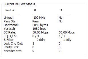

I am struggling to display the MIPI CSI-2 image from the 954-Q1EVM / 953-EVM kits. After probing, I do not see the reference clock 25 MHz active from your 954-Q1EVM. How do I make the Ref CLK active? I am sending the POC voltages and the Pass and Lock LED's are lit on the 954-Q1EVM.
I am using a Cypress CX3 Denebola RDK eval board with a custom adapter board to link the differential CSI data lines, CLK lines, and I2C lines between the CX3 and your 954-Q1EVM.
Below is my status after running the following Python scripts ( 954_script_A1_RX0_init_CSI0_broadcast.py    and    ovt_1280_1080_30fps_REMOTE_RevE2_ID7a.py). Please help provide any additional Python code I need to run to ensure the link is proper. Can you send me the Python Scripts to my email?  emilio.cuesta@te.com
My concerns are listed below:
-REF CLK not seen from the J24 connector
- "Current CSI TX Status" Port 0 Sync Status shows "No" , but the Pass Status displays "Pass". Maybe the REF CLK not being seen can be a cause.
Thank you for your assistance!
  • Hello Emilio,
    Based on the screen shots it appears everything is working fine. As a debug step, you could map the frame valid and line valid signals from RX0 or CSI0 out to GPIOs on the 954 EVM in the GPIO tab, then probe them to see if they are toggling at the expected rates.
    Also, are you using the top side or bottom side connection for the CSI-2 connection? If you are using the bottom side connection, you need to populate 0 ohm resistors to connect to the other side and remove the top side 0 ohms (see the EVM user's guide for details).

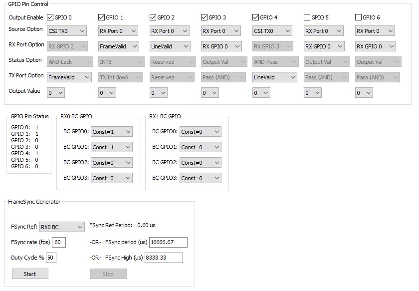

  • Hello Casey!
    Thank you for your timely response! I am using the top CSI-2 connection so there is no need to manipulate placed resistors right? Could you help provide verify my GPIO mapping is correct as you described? My attempt shown below... The GPIO LED's lit, results seen below (screenshot attached). What frequency should the CSI reference clock be? This is not seen and the Sync Status is set to "No" in my first screenshot.
    GPIO 1 = 30 Hz with high duty cycle
    GPIO 2 = 34 KHz
    GPIO 4 = 34 KHz
  • Hello Emilio,
    Top side - no need to manipulate resistors.
    The indicator measurements also show things are working correctly. The GPIO1 is showing the frame rate. The GPIO2 and GPIO4 are showing the line rate. Both look correct based on your setup.
    The CSI clock is a different clock then "REFCLK". The CSI clock speed depends on what CSI data rate you have programmed for the output. You can see it in the forwarding tab of the GUI.
    Casey

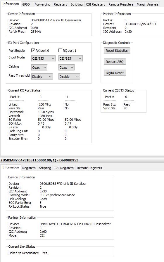

  • Hello Casey,
    Thank you... I now understand the CLK differences. I verified my CSI CLK lines are feeding correctly to the Cypress CX3. The clock must be too fast for the O-scope I have on hand (100MHz)...
    I currently have the Sync Status Set to "No" (see attached). Does this sync need established? If so, how? Thank you!
    BR,
    Emilio
  • Hello Emilio,
    Sync status is only applicable for synchronized forwarding modes which can be enabled when you have multiple imager inputs. In this case it can be ignored.
    Casey

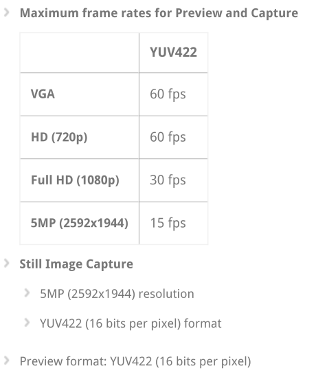

  • Hello Casey,
    TI provides 1920x1080 at 30Hz found in the PreDefScripts; however, those scripts are raw format. The script you provided to me (YUY2 format) provides a different resolution, see attached. Can the script you provided be modified for a 1920x1080 at 30 Hz? What lines in the code need changed? Thank you!
    Emilio
  • Emilio,
    The script provided is YUV2 (YUV422 8 bit format). For 8 bit YUV, there are 2 bytes per pixel, so the horizontal line size is double the horizontal active pixels. The resolution is correct.
    Casey

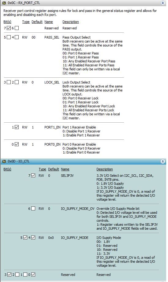

  • Hello Casey,
    How is this implemented? Through code or through the GUI? The attached shows the registers you referred to through the GUI. How would l create a 30 Hz frame rate? Line period should be 0.033333 seconds... How do I implement? Thank you!
  • Emilio,
    The 0x0C and 0x0D registers I was referring to are in the PATGEN indirect registers. Please referce datasheet section 7.5.11 for information on accessing the PATGEN registers and configuring PATGEN. It can be done through the GUI either in the register tab or by editing the script I provided. The line period in DEC is calculated with the following equation:
    ROUND(1/("Frame Rate in Hz"*"Total Lines*0.00000001),0)
    I can confirm that based on the script I gave you it should already be at 30Hz because total lines were 1125, line period is 2963*10ns
    Casey
