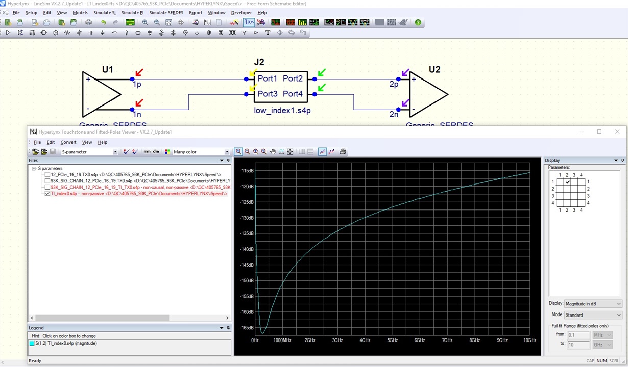

I downloaded the S-Params models for the part, and run a simulation in HYPERLYNX.
I used the low_index1 model, which was supposed to show a equalization of 0.4dB. Instead I am seeing ~-120dB
Something seems out of wack.
This is what I am doing in FreeSim and the results:
  • Hello-
    The DS160PR410 is a differential device.  You need to look at the differential insertion loss parameter (SDD12), not single-ended (S12).

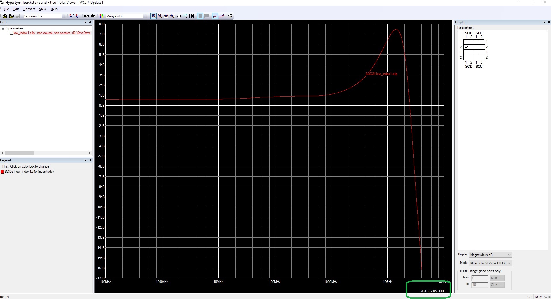

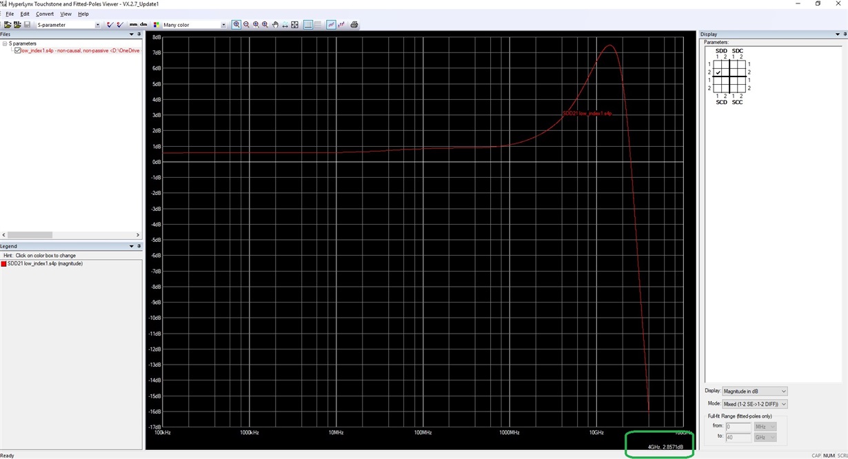

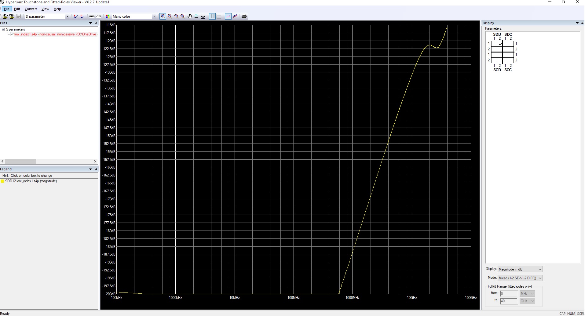

    The SDD12 model you suggest I use, when using LOW_INDEX_1 model looks like this.
    The SDD21 looks more like the one from the data sheet:
    ...but this is still confusing, because TABLE 1 shows a gain of 0.4 @4GHz, but the model shows a gain of 2.85dB
    So, I'm still not sure how to use this model.
    Is the model made for the RX or for TX? Since SDD12 is so low, it seems to me that this is the model for the receiver and I have to use SDD21 for that, and not SDD12 as you suggested.
  • Hello-
    That was my mistake.  I was thinking SDD21, but mistakenly suggested SDD12.  I'm sorry for the confusion.
    Let me look into the 0.4 dB to 2.85 dB @ 4 GHz discrepancy to see if I can determine the root cause.
    Davor

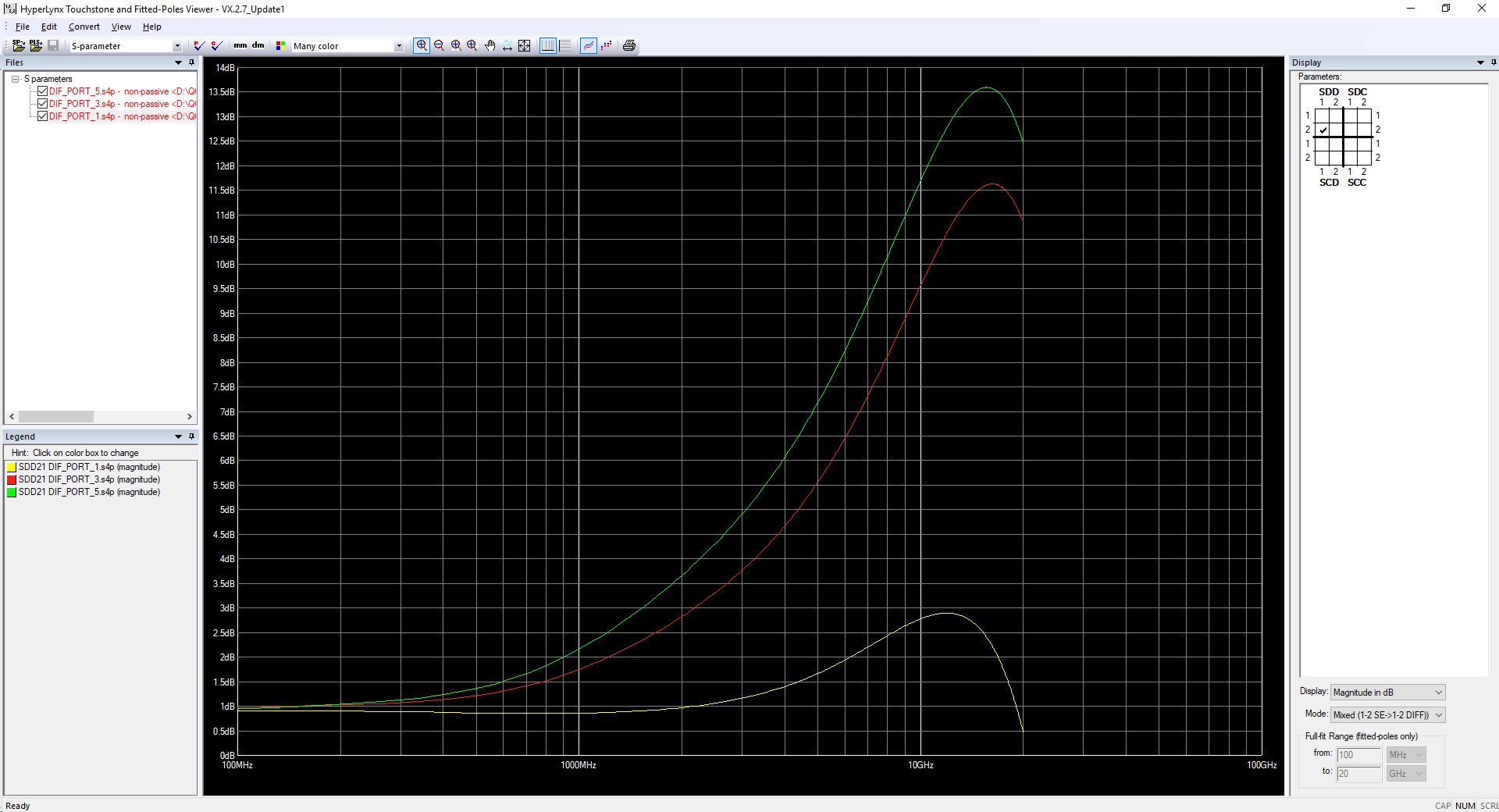

  • I got the new models. Thanks.
    But I am still not sure how to read this. This is what I got for indexes 1, 3 and 5. The peaks are not quite where Figure 1 shows them
    According to that figure,
    index 1 should peak at ~5dB but the model peaks at 2.9dB
    index 3 should peak at ~15dB but the model peaks at 11.6dB
    index 5 should peak at ~16-17dB but the model peaks at 13.58dB
    What am I missing?
  • Hi Traian,
    The S-parameter models are simulated models while Figure 1 in the datasheet shows actual measurements.  We are aware that there is discrepancy between the  simulated and measured EQ gain curves.  However, given that the EQ gain can vary around  +/-2  dB at 8 GHz across PVT, the discrepancy is within the expected variation.
