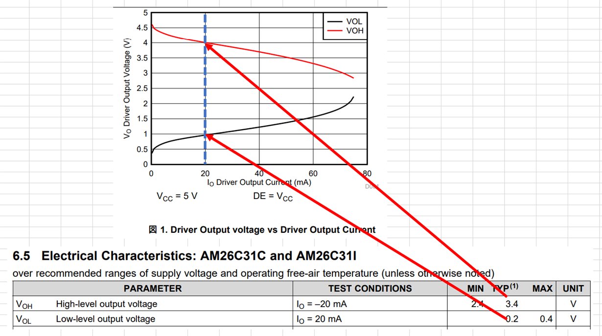

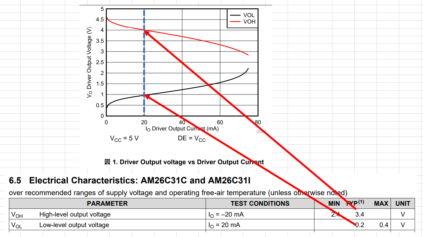

Do you have the data of VOH, VOL vs output current?
Kuramochi
Kuramochi,
Some lab data shows the driver performance of AM26C31 is similar to that of THVD1500. You can refer to Figure 1. in section 6.8 (page 8) of the datasheet of THVD1500. Please let me know if you have more questions.
Hao
Hao-san,
We have an additional request.
Could you provide the Voh and Vol graph by the document format including product name(AM26C31) and "Texas Instruments"?

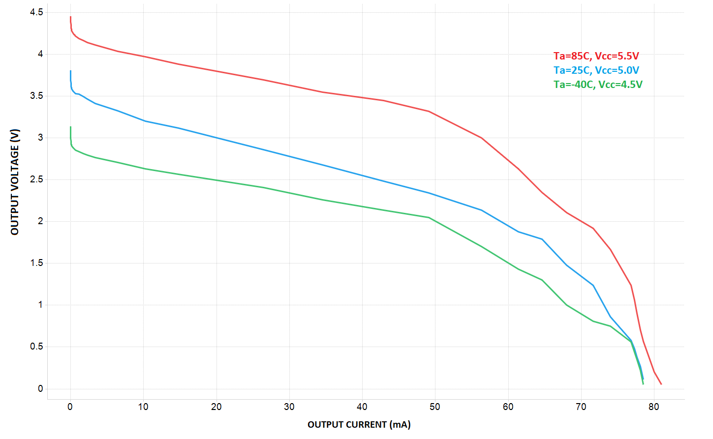

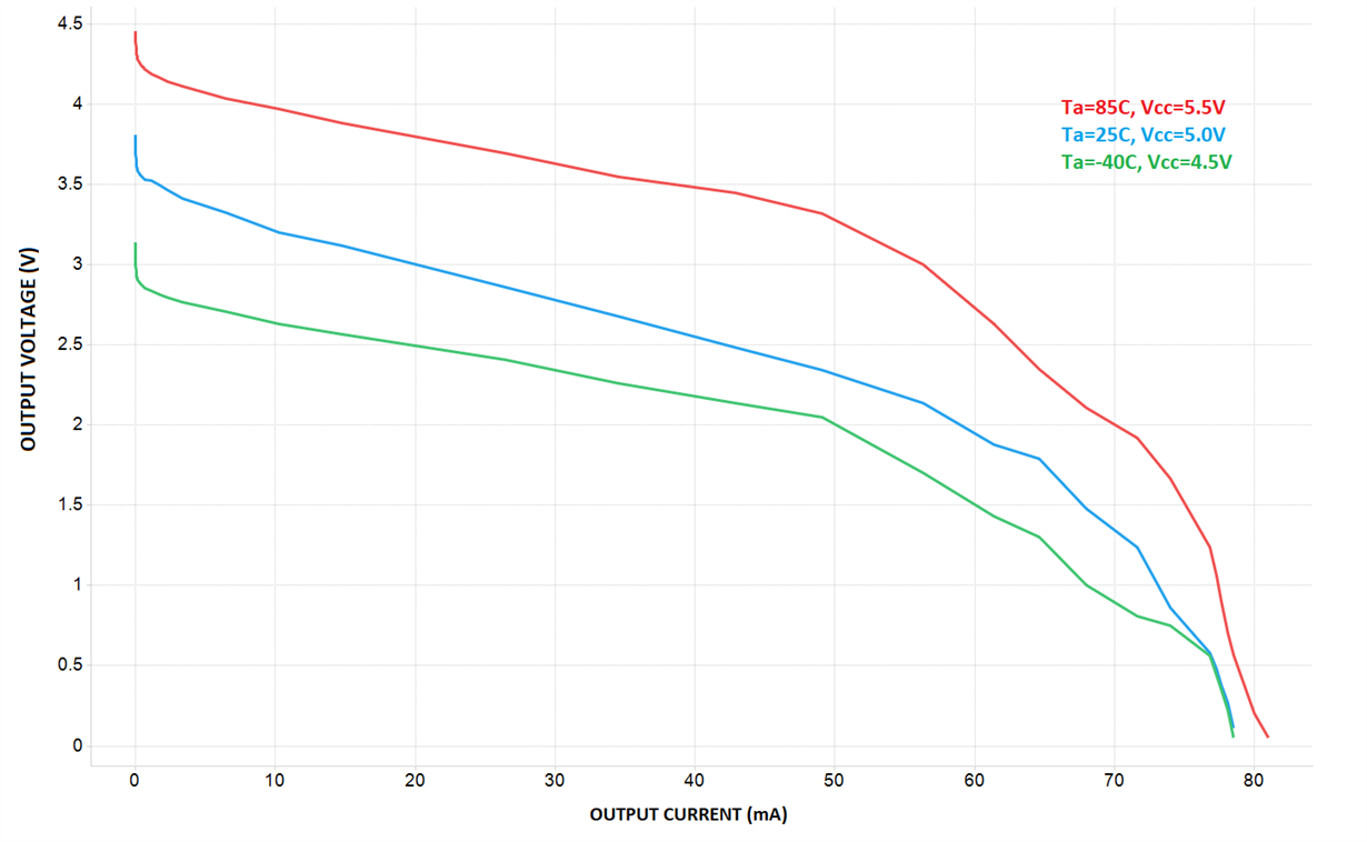

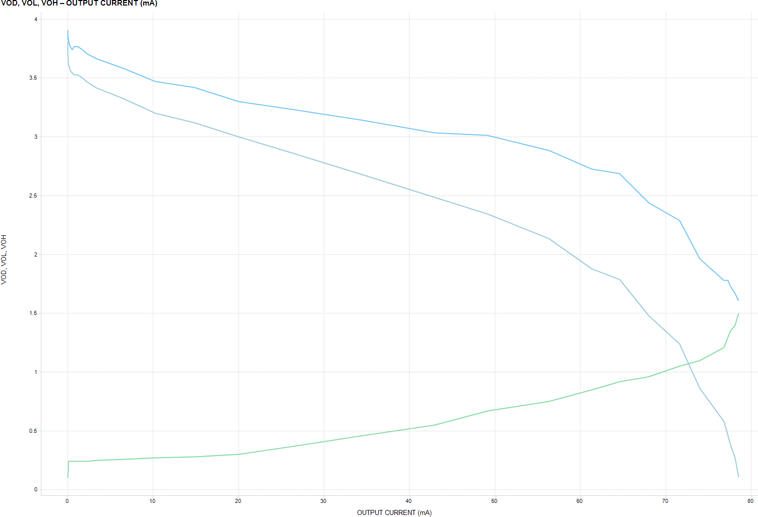

Kuramochi-san,
I'm sorry for the delay. The data will be available in a couple of days. Regards,
Hao
Hao-san,
Could you give the measurement condition and the legend?
