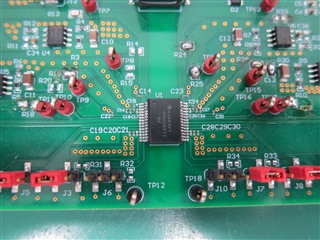

    Can you please share a close-up photograph of ISOUSB211 chip so that I can read the top marking?
    I am showing below an example chip where the top marking is clearing visible. Thanks.
    Koteshwar Rao

    I will send you an image of my EVM.

    It looks like the EVM has pre-production X-marked sample (XISOUSB211). It would be helpful to test the current samples. To order current samples for free, could you please place a request at the link below by clicking "Request sample" under the column "Samples"?
    https://www.ti.com/product/ISOUSB211#order-quality
    Once you receive the samples, please replace the EVM with new samples, test again and let us know the results. Thanks.

    I replaced it with a new isolator IC without the X-mark and confirmed that the issue was resolved.

    Thank you for testing the EVM with new sample and glad to know that it resolved the issue.
    The X-marked sample is a pre-production unit which is slightly different from the released units, therefore, the issue is explainable.
    Sorry that this issue took too long to resolve. Since the released silicon doesn't have this issue, I hope you can still use this device in your designs.
