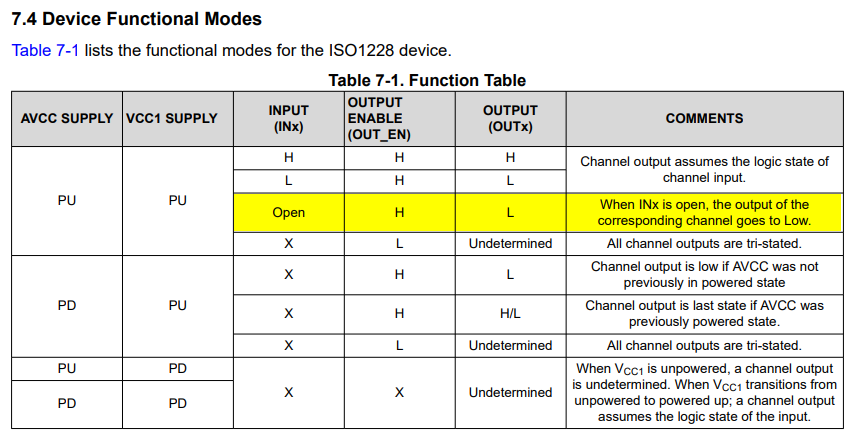

I’m currently working with the ISO1228 device to interface field digital inputs (typically 24–28 VDC) to a microcontroller with isolation.
According to the functional table in Section 7.4 of the ISO1228 datasheet, when an input pin (INx) is in an open state, the output (OUTx) goes Low, as described:
“When INx is open, the output of the corresponding channel goes to Low.”
This behavior aligns well with our application. Specifically, we are using ISO1228 to detect discrete input signals in two configurations:
  • Open/GND: where GND = logic LOW, and open = logic HIGH
  • Open/28V: where 28 V = logic HIGH, and open = logic LOW
In both cases, open is treated as a valid logic state, not a fault condition. This is intentional and required behavior in our design.
However, I’ve seen some documentation or comments that suggest ISO1228 treats open inputs as undetermined or as a wire-break fault. To avoid any misunderstanding, could you please confirm the following:
  1. Is an open INx input consistently interpreted as logic LOW, per Table 7-1?
  2. Is this behavior safe and deterministic for production applications?
  3. Is there any internal timeout or protection logic that could interfere with intentionally floating inputs in open/GND or open/28V configurations?
We want to ensure ISO1228 behaves predictably when inputs are intentionally left open in these discrete signaling schemes.

  • Hello Sam,
    Please see our answers below:
    • Open INx Input Behavior:
      According to section 7.4 of the ISO1228 datasheet, if an INx pin is left floating (unconnected), will the corresponding OUTx always be interpreted as logic LOW?
      • Yes, this is the standard setup for a the typical feild sensors that ISO1228 is designed for since this enables wire-break detection.
      • A given OUTx will be low when the corresponding INx is open (and OUT_EN is enabled).
      • Aaditya showed this condition in the truth table earlier

      In Figures 10-1 and 10-2 of the ISO1228 datasheet, mechanical switches connect INx to either GND or 24V. If the switch is open (floating input), is this deterministically treated by the device as a logic LOW?
      • Yes, an open INx is treated as a logic low.

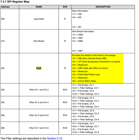

      • General comments, and fault register map shown below:
        • There are protection features on the ISO1228, and they should not affect how the input is handled since they can be programmed for your needs. The main feature would be the (7.3.6) Digital Low Pass Filters (other features can be seen in 7.3 Feature Description).
          CRC or Internal Fault Behavior: Could the ISO1228 generate CRC or internal integrity errors due to environmental conditions such as:
        • The fault protections features (7.3.5 FAULT Indication) are available when serial (SPI-mode) is enabled. A presence of a fault can also be detected using the nFault pin in parallel mode. How to Dynamically Switch Between Serial and Parallel Modes Using ISO1228 shows a use case where a fault is detected in parallel mode and then further investigated using the fault register in serial mode.

    • Recovery from Faults: If such a fault does occur,
      • Does the device enter a fault or lock-up condition?
        • The fault will be recorded in the fault register however the device will operate as normal (no lock up). The App note above describes the behavior under fault conditions. Dynamically switching between modes can be used for further. Otherwise, any fault can be detected on the nFault pin in parrallel mode.
      • Would a hardware reset be required to recover, or can the device self-recover?
        • ISO1228 will self-recover once the fault condition is cleared (assuming the fault did not cause device or system damage). nFault pin will reset when the fault register is read.
