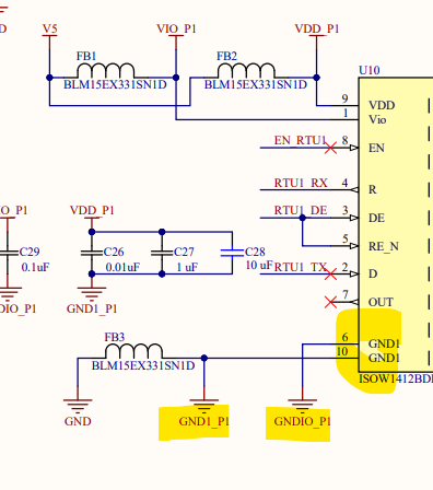

I have an ISOW1412 that is configured like the datasheet articulates for a half duplex interface. I am having a problem with the DC to DC Isolation regulator drawing high current before it starts to regulate, this can go on for several seconds and cause the device to get very hot, it starts out at the Clamp voltage and then eventually down regulates to the proper voltage. This happens in both the 3.3V Output configuration and also the 5V Profibus configuration. If I allow the VDD and VIO which are both configured for 5V to come up with the EN pin pulled to ground the device is initially disabled and draws only 20 mA or so staying cool, if enable is then brought high the high current draw occurs. So the issue occurs both when starting enabled and allowing VDD and VIO to ramp up as my 5V regulator comes up and also in the absence of any power sequencing issues using EN. Once it starts regulating a quick power cycle will regulate in a few milliseconds, if its allowed to sit a while the high current draw occurs again. What would cause this behavior.

  • RS485_ISO_B.pdf
    Here is the requested schematic, the VIO and VDD are common at 5V and I am using Profibus mode. For some additional clarity when the regulator starts correctly it takes 2 milliseconds to begin regulating to 5V, when it does not it can take 20 - 30 seconds before regulating properly, during this time no Fault signal was generated and if I monitor the VISOOUT voltage it quickly goes up to almost the 6V clamp voltage and slowly decays down until it falls below 5.6 volts at which point the regulator starts and it drops below 5V and starts to regulate. I have tried changing the bulk capacitors C23 and C25 from the ceramic dielectric ones used on your evaluation board to Tantalums to increase the ESR so that the initial VISOOUT voltage stays below 5.6 volts without much success. I am considering what may happen if I add a 5.4V Zener on VISOOUT load point to accomplish the same.

  • Hi Roy,
    Based on the Schematics, the GNDIO and GND1 pins are not at all connected which is what is making the device go out of regulation.
    Please fix this connection as per datasheet and test again to see the true device behavior.
    Varun
  • Thank You Varun, this was the problem thanks for the assistance.
