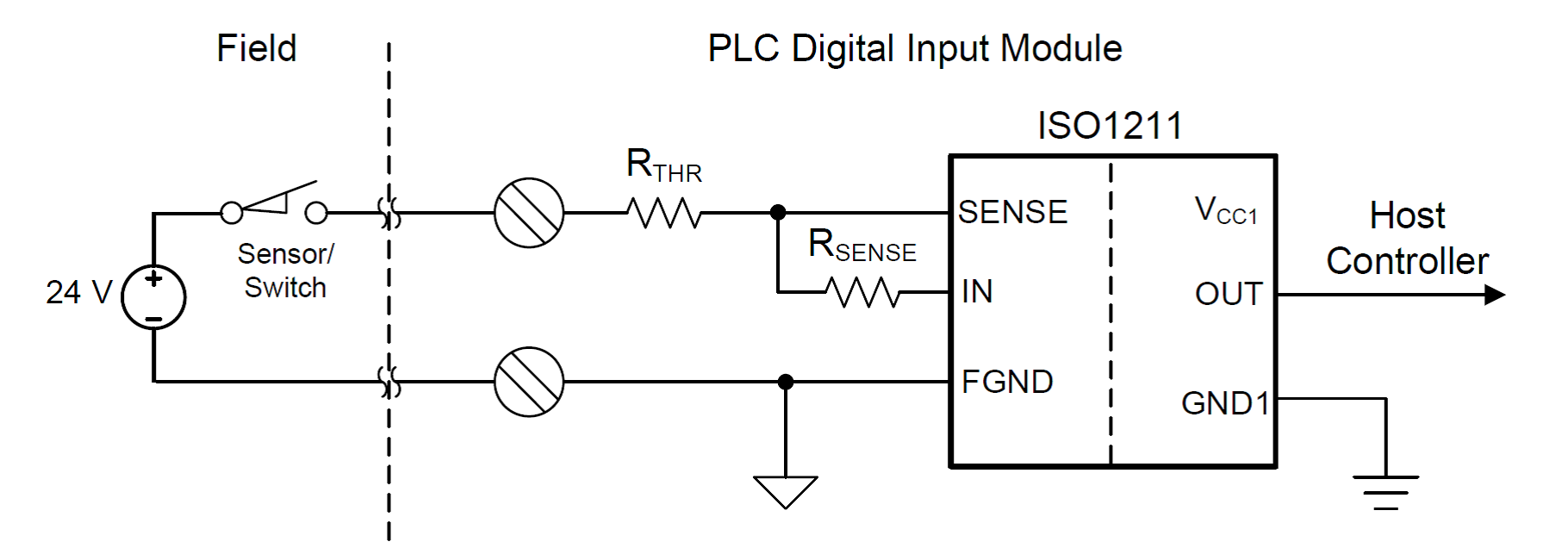

I want to replace a typical optocoupler based 24 V input with a ISO1211 or ISO1212. The optocoupler doesn't care if it is connected to a high- or low side switch.
Since I want to stay compatible, the ISO121x circuit has to support high and low side switches. But in the datasheet it seems that I have to connect Rthr to FGND instead of SENSE when connecting a low side switch (called "Sourcing Inputs" in the datasheet).
1. What is the reason for this?
2. What happens when the ISO121x is configured as "Sinking Input", but is used as "Sourcing Input"?
3. Would it be useful to split Rthr into two resistors, with Rthr/2 connecting to SENSE and Rthr/2 connecting to FGND when I want to support both configurations?
A followup question:
I tried to fiddle around with the TINA-TI reference design, but was not able to get a working simulation for a sourcing input configuration. Is the simulation model limited in this regard?
