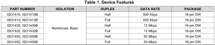

What is the difference between ISO1430 and ISO1430B? From datasheet, I can't find any difference.

Isolators with a "-B" suffix meet "Basic" isolation requirements per DIN VDE V 0884-11, and those without it meet "Reinforced" isolation requirements.
Details can be found in the Insulation Specifications and Safety-Related Certifications sections of isolator datasheets (included below).
