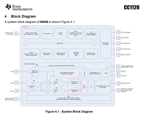

  • Information about the CC1120 you can find here: http://www.ti.com/product/cc1120
    On page 20 in the datasheet it is a simplified block diagram over the chip. The RF signal is amplified in the LNA, splitted in a I and Q path by a mixer and further amplified before entring the ADCs. The gain in both the LNa and the IF amp is variable but no processing on the received signal is done before after the ADCs. For your application you have to do your own signalprocesing/ demodulation on the raw data to be able to extract the data you are interested in.

    There are LPF0 and LPF1 PINs, and they should be Low Pass Filter output PINs. From the diagram on Page20, the two PINs are before the ADC.
    So I guess, if these two PINs are the only PINs that can output raw I/Q data, they output analog data. Right ?
    Are there some PINs right after the ADC, to output digital raw I/Q data ?

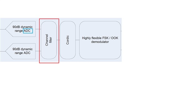

    Can you please let us know what is function of the channel filter, and that of the Cordic (we have knowledge about these though. But the questions still have to be asked because in some scenarios people refer to different concepts by the same terminology) ?  In other words, what kind of signal is output from the channel filter and Cordic ?
    -- If there is some detailed documents we can read about those blocks of CC1120, that is the best.
    I guess what we need may be as simple as: the output of the channel filter (if the channel filter functions just as a low pass filter) ; or may be the output of the Cordic.

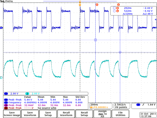

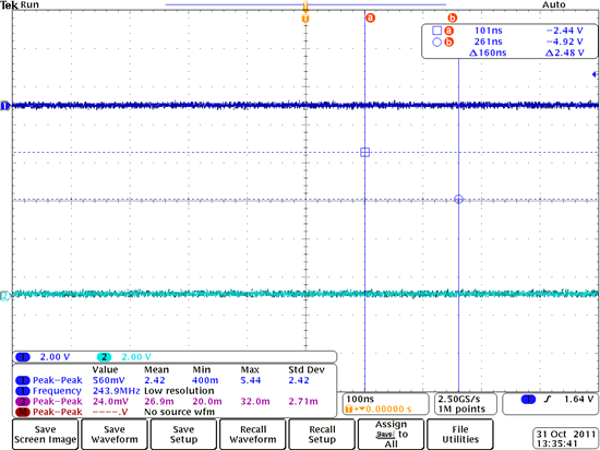

  • Hi
    Thank you very much for your former responses and your help. We really appreciate.
    Now The problem is like this: we always get the same output from the receiver, regardless the transmitter is on or off.
    The image from Oscilloscope. The transmitter is on, this image shows what the receiver get from its ADC output.
    The image from Oscilloscope. The transmitter is off, this image shows what the receiver get from its ADC output .
    (Even we tried this test in the shield room where there is no interference, we still got the same result)
    Details of configurations: we use SmartRF studio and CC1120DK (two boards), and make "IOCFG0 = 2E, IOCFG2 = 2E, " according to the Table 8 of CC112X user guide, as the attached PPT shows:
    Best regards
    Bo
  • Note that SmartRF Studio uses some of the IOs when in "continuous Rx" (IOCFG2) and "package Rx" (IOCFG2 and IOCFG0). If you are using one of these options you probably are monitoring the wrong signals.  To have full control over the IOs, use the "RF Device Commands" tab and send the SRX strobe to put the chip in Rx.

  • 1) and 2): Before I sent yesterdays answer I checked that it worked. I used the "RF device commands" tab, sat IOCFG2=IOCFG0=0x2E and connected a logic analyzer to the GPIO2 and GPIO0 connectors on the TRxEB. Then I got a signal out when I strobed RX, not when I strobed TX or Idle. I get different result each time I stobe SRX which is consistent with receiving noise. Even when the transmitter sends a modulated carrier the bits sent out on GPIO2 and GPIO0 will be different each time SRX is strobed due to the nature of a sigma delta.
    3): Strapping is not required. This is only used in some cases where you have a board with CC1120+CC1190 and want to control the required control signals on the CC1190 from the MSP and not from CC1120.

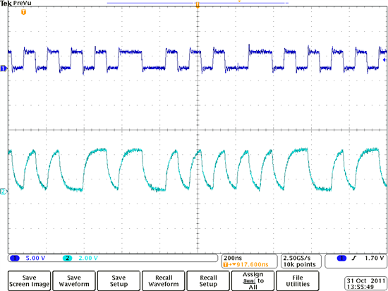

  • Hi
    Thanks for your former responses.
    We carefully repeated the same testing, and get the same result as yours, that is: GPIO does output nothing when STX is strobed. The GPIO does output something when SRX is strobed and it outputs different waves each time.
    However, the wave it outputs are actually the same type regardless the transmitter is on or off, when SRX is strobed. We expected to get some signal from receiver's GPIO when transmitter is on, and no signal (or another totally different type of signal) from receiver's GPIO when transmitter is off. But regardless the transmitter is on or off, the output of GPIO is still the same "type". That is, from the output of GPIO (the oscilloscope), people cannot tell whether transmitter is on or off. -- This can not be right.
    Please see the output of GPIO as the pictures below:
    This above picture is the output of GPIO/oscilloscope when transmitter is off, SRX is strobed on the receiver.
    This above picture is the output of GPIO/oscilloscope when transmitter is on , SRX is strobed on the receiver.
    (we used a very good signal generator as the transmitter, and when the signal generator is on, the RSSI jumps up on the receiver which means the configuration of the signal generator is right.)
    This above picture is the output of GPIO/oscilloscope when STX is strobed on the receiver.
    Thank you very much for all your help and efforts. We really appreciate it.
    Bo and our group.
    PS: we are really anxious about this test, and we have tried over a month in here. Is there some other way we can try ? EMAIL : hongbog@ece.ubc.ca
  • Is it possible to probe before ADC ?  (That would be really helpful)
  • Please keep in mind that a sigma-delta converter achieve good resolution by shaping the quantization noise. For a conventional ADC with n-bit output the noisefloor (quantization noise) vs frequency is flat. For a low pass sigma delta modulator the quantization noise is shaped so the noise energy is much larger on high frequencies than in low. Hence a sigma delta ADC contains of two parts(simplified): A  modulator and a lowpass filter. The modulator shape the noise and the filter removes the noise at the frequencies of no interest. The bit stream out from CC1120 is the output of the sigma delta modulator. Even with no input to the modulator will shape the quantization noise and the result is that the bit stream is not a stream of '0'. It is not possible to see from just a few samples of the bit stream what the input signal to the modulator is. To see this you either have to lowpass filter the stream or run a FFT on the data (in the simulations I did I used at least 6000 samples). Hope this makes it more clear, sigma-deltas is not straightforward.
    Also note that you will lose ~10-15dB in sensitivity by using the GPIOs to output the data due to the noise the pads introduce. An alternative is to output the data on the LVDS interface (not documented but used in the lab with no decline in sensitivity). The datastream on the LVDS interface is clocked at 2xcrystal frequency and has to be oversampled in the receive side adding cost and current consumption.

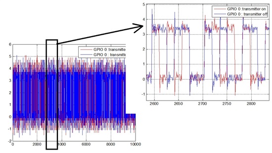

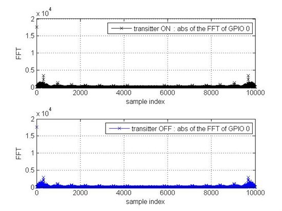

    ADC has three blocks: sample, quantization, coding. Let say an input analog signal is pi, then after sample it is 3.14159, after quantization it is 3.14, then after coding it is 1000100... (n bits), which is a 0/1 bit stream. I trust this 0/1 bit stream is the output of the output of GPIO or ADC.
    1, Now that we can trust the output of GPIO is the ADC output of the raw data, which is a 0/1 bit stream, how to decode this bit stream ? Information about the ADC is needed. For example, this is n-bits ADC, then how large is this n ? What is the sample rate ? How to find the start of each sample (suppose each sample is quantized into n bits.) ?
    2, How to lowpass filter the output of ADC ? I mean, do we input the bit stream into a low pass filter ? Or do we first decode the bit stream (decode it back to a sample of the transmitted MSK symbol) and then input the decoded sample stream into a lowpass filter ? -- Another expression of this question could be : how does the channel filter in CC1120 work ?
    3, Similar as question 2, I tried directly perform FFT on the output of GPIO, but this seems not make sense, since this output of GPIO is not the sample of some signal. It is a 0/1 bit stream which comes from of the quantization of the sample of TX signal. The 0/1 bit stream is not supposed to be directly done by FFT (The figures below:)
    The above figure is the output of GPIO 0 (Transmitter ON and OFF)
    The above figure is the FFT of the output of GPIO 0 (Transmitter ON and OFF -- they are the same ?!)
    If there are some manuals regarding the ADC , the channel filter, the cordic, the demodulator, that would be most helpful.
    Best regards
    Bo
  • "ADC has three blocks: sample, quantization, coding. Let say an input analog signal is pi, then after sample it is 3.14159, after quantization it is 3.14, then after coding it is 1000100... (n bits), which is a 0/1 bit stream. I trust this 0/1 bit stream is the output of the output of GPIO or ADC. "
    Yes and no. As I have written before the ADC is a single bit sigma delta modulator with Xtalfreq/2 sample rate. From what you write I get the impression that you are not too familiar with sigma-delta modulators, please correct me if I'm wrong. If you haven't used one before, please look at the "delta Sigma Toolbox" (http://www.mathworks.com/matlabcentral/fileexchange/19) that will give you some insight in how they work. The book Richard Schreier has written on the subject is also a good intro. You should also be able to use some of the functions in the toolbox to run FFT on the datastream and plot it in a more readable format than you have used. When plotting the spectrum from a sigma-delta it is normal to plot dB (20*log10() ) on the y axis and use a logaritmic x axis.

  • Hi
    On the CC1120DK (TRxEB),
    is there some PIN to get the output of the channel filter ? (In CC1120 block diagram, its channel filter is after ADC
    I suspect the channel filter of CC1120 functions as the filter&decimator as depicted in the dash line box below:
  • 1, what is the IF frequency ? (say, 1MHz, or 100KHz ?)
    See 9.2 in the UserGuide.
    2, Sampling rate of the sigma-delta ADC
    See my previous post.
    3, the center frequency of the channel filter
    The center is the IF frequency
    We don't have a supported way to output data after the channelfilter on a GPIO

               Here are the questions:
               Q1: What configuration that is need to configure for strobes signal to output from GPIO ? (Strobe by falling or raising edge)
                      Is it CLKEN_SOFT[IOCFGx.GPIOx_CFG = 29] , SOFT_TX_DATA_CLK [ IOCFGx.GPIOx_CFG = 30], or other ?
               Q2: Where is the LVDS interface in CC1120 ?
    Robert Lin
  • Hi Robert
    Send me an email if you are interested to discuss/talk with me. I can send you my tel number through email.
    had been working on the I/Q ouput (i.e., GPIO) for months when I was making my prototype using CC1120 board.
    Maybe I can help you a little bit.

    Robert Lin2 said:
    Hi TER,
             Thank you for answer. Next step, we are going to use CC1120 I/Q output to ingreate with our exsiting baseband board for verification.So we need to you help to clarify how to use them. As you answer, "it is possible to have a signal out on GPIO that strobes when valid data is in the registers, see table 10 in the userguide."
    Robert Lin
