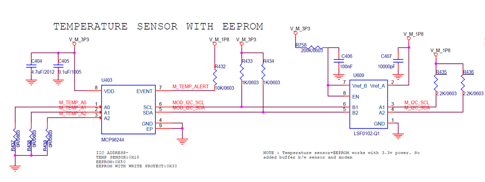

Inquiries were received during the design of the LSF0102-Q1 from a customer.
Please review the attached circuit.
The recommended value for the pull-up resistor of HOST (Modem) connected to LSF0102-Q1 is 2.2kohm.
Are there any possible problems when applying the corresponding resistor?
Or is there a value you can recommend?

  • Hey MJ,
    I don't support the TCA9517 device so I can't comment on its functionality. As for the LSF device, those pull-ups are no problem for it. The size of the pull-up will determine the rise time and thus the overall data rate. I2C speeds are typically slow so 2.2 Kohm will likely work just fine for that.
  • The LSF is a passive switch. When a line is pulled low, there is a direct connection between the two sides, and both pull-up resistors work in parallel. Check that all devices are able to drive the resulting current.
    The TCA9517 is a buffer, so both sides are isolated.

    Do you have any comments on the overall schematic?
    If you have any opinions on the circuit diagram in the first inquiry, please respond.
    Thanks.
    MJ
  • My comments do apply to the schematic. 1 kΩ || 2.2 kΩ ≈ 688 Ω, so you might want to use larger resistors, for example, 4.7 kΩ on both sides.
    With the TCA9517, you could use 2.2 kΩ on both sides.
    Why were 1 kΩ resistors chosen for the 3.3 V side?

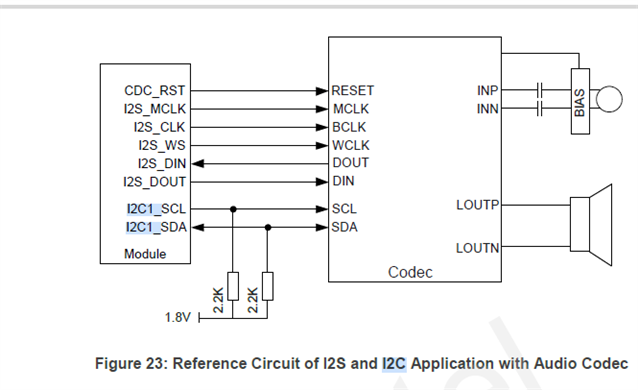

    Pull-up resistor values are applied based on the table below.
    Based on the above table, it is a question to ask if it is possible to apply 2.2kohm based on modem for 1.8V line while applying pull-up resistor.
    Are you okay?
    Is there no problem for the whole circuit?

  • Hey MJ,
    There are no issues with the circuit. I recommend watching these training videos over the LSF family. If the interfacing devices aren't able to sink the current from the pull-ups on both sides of the device, then you will need to increase the size. Video 6 in the training series will help you calculate resistor sizes for your system.
  • The smallest current in that table is 3 mA, but this does not mean that 3 mA would be the smallest current that you can use.
    You need high currents only for high-frequency signals. I²C is very slow, and typically works with 1 mA or less.
