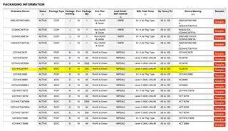

Hi Team
My customer want to know CD74HC367MT need packaging details of part, could you help me to give your suggest.
Thanks in advance!
William
  • Hey William,
    This information can be found in two locations in the datasheet. First, on the front page
    and second in the package option addendum
    CD74HC367 is the generic part number. The M denotes the package type, in this case a 16 pin SOIC. The T indicates that a small-quantity reel of 250.
    Pages 13 and 14 of the datasheet  will show more information about the dimensions and pitch of the package itself, including recommended footprint for soldering the component down.
