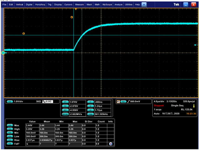

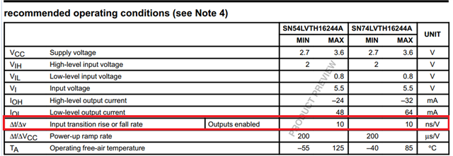

Hi Team,
You know our SN74LVTH16244A defines the max Δt/Δv should below 10ns/v. Pls see below datasheet screenshot.
But currently customer's slow input signal cannot meet this specification. What the risk is if the signal slew rate cannot meet our device's requirement? I also attach customer test waveform for your reference.
