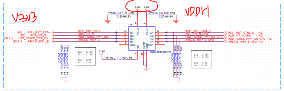

More specifically, please see below figure, VDDH and V3V3 are from different power rails, but are both 3.3V.
Can we use TXS0104 like below, so we don't have to worry about VCCA would be larger than VCCB and cause the internal protection diode that can become forward biased.
Thanks a lot!
