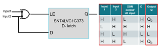

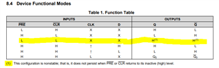

SN74LVC1G74: PRE=L CLR=L ,what will be the output Q?
Part Number: SN74LVC1G74
Other Parts Discussed in Thread: SN74LVC1G373, SN74LVC1G99, SN74LVC1G125, TLV803E
I need to understand the condition PRE=L, CLR=L, D=X, CLK=X. So that I can decide the logical usage of this Flipflop. Is there any timing constrain to make this state stable.
