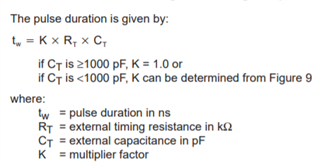

I am designed a timing circuit with SN74AHC123A
Requirements are Tw=22uS, VCC=3.3V
As per the calculation I have selected 1nF(1000pF) and 22.1K resistance.
But when I am observing , the output is around 50uS pulse width.
If I changed the capacitor to 10nF(10nF*22K=220uS), I am getting around 220uS.
Again if i Change the resistor to 2.2K and 10nF(calculated value 22uS) , again I am getting 50uS.
What can be the reason for this behavior?
