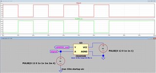

I simulated with CD4050B spice model (download here): ti.com/product/CD4050B
But the result showed that CD4050B is inverted logic not non-inverting buffer. Why is that ?
BR!
My simulating result is below:

Hi BR,
Sorry for the inconvenience. There is a mistake with the model. I have created a new model so that it is non-inverting here.
