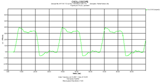

  • Waveforms:

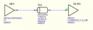

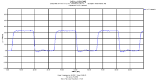

Case 3: Level translator to Artix-7
FPGA part number: XC7A200T-1FBG676C
FPGA Buffer model: LVCMOS33_F_8_HR
Level translator part number: SN74LXC8T245QPWR
Buffer model: input_3.3V
Schematic:
Trace length: 10 inches;
Trace width: 5 mils
Frequency: 32 MHz
Waveforms:

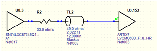

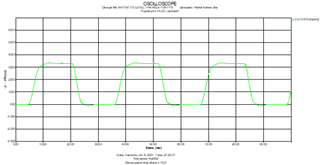

Case 4: With 33 ohms series termination:
Schematic:
Waveform:

    As per our analysis, below points are we noted in SI simulation
    1) FPGA as driver (XC7A200T-1FBG676C drive strength is 8mA) and level translator is receiver (SN74LVC16T245). In this case we got good waveform. (Trace length is 10Inch, trace width 5.1mils)
    2) Level translator as driver (XC7A200T-1FBG676C drive strength is 24mA) and FPGA is receiver (SN74LVC16T245). In this case we have issue. we got overshoot and undershoot. (Trace length is 10Inch trace width 5.1mils). In this case we added series termination (22/33 ohm resistor) near by the LVT . VME interface data lines are Bi-DIR signals, so when we add series termination FPGA (Driver) to LVT (Receiver) rise time and fall time are increasing. LVT (Driver) to FPGA (Receiver) rise time and fall time are more increasing.
    3) FPGA to LVT in-between we added Buffer (SN74LVT16245B). this buffer also not resolved issue.
    please share relevant trace guidelines
  • Hi Siva,
    In the waveform you posted for case 4, the overshoot improves significantly compared to case 3 without the series resistor at the output of the LVT. The overshoot cannot get much better than that so keep this in mind when designing. Regarding the increasing rise and fall times, this is the design trade-off in order to get lower overshoot and undershoot. Also, the supply voltage will fluctuate by more than that overshoot so the output cannot be guaranteed to stay under 3.3V. You must keep a 500mV tolerance on either side.
    Sebastian
