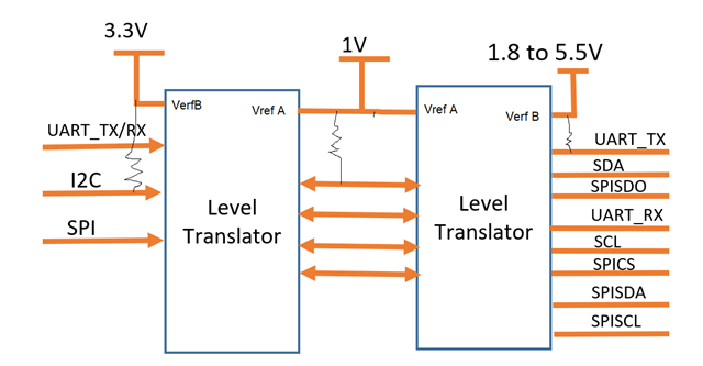

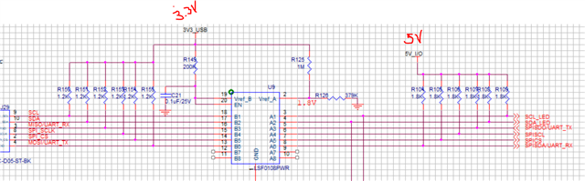

Hi Team,
My customer is using SN74GTL2003RKSR Level translator in my Design, I have query on Sref & Dref Voltages.
Applying Sref=3.3V, and Dref=Gref=1.8V to 5.5V,
Will it work fine for Dref varying from 1.8V to 5.5V ?.
Please find attached Image.
Thanks Shinu.
