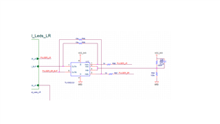

the input is a pulsar with an amplitude of 3 volts, what should be in the comparator output?

One little correct to Clemens answer. There is a fair amount of hysteresis added to this circuit, so the transitions from low to high will occur closer to 2.7V and the high to low transition around 2.4V.
