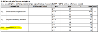

We are proposing the SN74HCS08DR to replace the SN74HC08DR.
Pls confirm whether is true of Overlap of switching threshold of datasheet.
Examples for 4.5Vcc :
Positive switching threshold is 1.7V ~3.15V
Negative switching threshold is 0.9V~2.2V
The information from applicant report (SCEA046),there is no Overlap of switching threshold.
Pls advice.

  • Hi Eric,
    VT+ will always be larger than VT-.
    Please note that there is a third specification in regards to the input threshold:
    For example, at 4.5V operation, the difference between VT+ and VT- will be at least 0.4V, and at most 1.4V.
