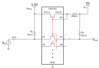

Hi
I am working on LSF0108 EVM and powered up the part with VrefA = 1.2 V and VPu = 5V by using triple power supply E3631A . I provided 1Mhz signal from function generator and see the my input levels 0 to 1.2V. The input levels are dropped 0.68V to 1.2V as soon as I connect function generator output to LSF EVM board on A-side and output is ~1.4V to 5V on B-side instead of 0.35V to 5V.   Can you please let me know what is wrong on my setup for UP transition.
Observed that there is relation between power supplies if I sweep the supply Vref-A from 1.2 to 2.7V and high side is also not 5V anymore(dropping from 5V ). Is this expected? if yes my levels are always rail to ref-A when i was doing Up transition.

    Just to verify, it sounds like this is your setup:

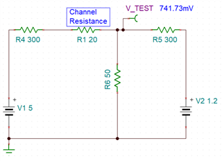

    If V_G is 0V, then we can see that V_REF_A and V_PU are both going to be pulling up the line (because the channel FET is on), and we end up with this relatively simple resistive network to solve:
    The voltage at the output of the generator / input at A1 should be around 740 mV -- and that may vary a bit depending on the channel resistance.
    In order to get that value down closer to zero you either need a low impedance signal source (aka a stronger driver) or larger pull-up resistors.
    Is this translator intended to be used with a 50 ohm signal source, or in a logic circuit?

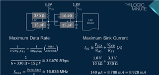

  • Hi Gopi,
    Please see this video for details on calculating pull-up ranges based on your system requirements & parasitics: Up Translation with the LSF Family | TI.com Video
    Snapshot from 4:56:
