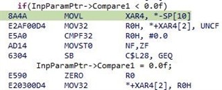

However, though I use the conditional operator, I don't see any change in the assembly as those images are attached below.

    Initially I tried using conditional operator & there is no difference. You can observe the same disassembly code in both the figures as shown below.
     With Conditional Operator
    If else loop
    Finally, the below syntax worked for me. In fact I forgot to assign the return operator of __lmin Intrinsic.
    var2 = __lmin( var1,var2 );
    But I surprised that the conditional operator didn't work.
