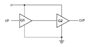

I need to interface a Logic gate G1 with another Logic gate G2. Please see the figure below. As per my knowledge, the below conditions should be met.
May I know I am correct or not or missing anything.
Voh(G1)>Vih(G2)
Vol(G1)<Vil(G2)
Ioh(G1)>Iih(G2)
Iol(G1)>Iil(G2)
