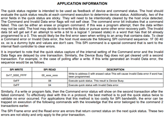

You may be reading the registers before the device is ready. The quick status register is intended for use as a feedback system to determine the device / command status between each command sent.
