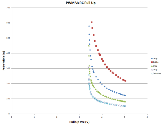

  • Did some testing with a simple RC and varied the pull up voltage gets the following results. Working on the knee of the curve in this configuration, seems to put me just outside my range in the linear regions.
  • H'm... the curves look like they don't go low enough to satisfy your range requirement without being annoyingly sloped near the (device- and temperature-dependent) trip point. Given that you have some headroom between the supply voltage and the ~3.3V trip point, you could get more DAC range by using the DAC and a resistor to generate programmable current sink and a PNP current mirror (e.g. BCV62) to source a copy of that current into the timing capacitor in lieu of the pull-up resistor. It produces a frequency (1/delay) linearly proportional to DAC setting, but at least you have more range (it caps when the DAC voltage is supply - 0.7V) to work with. I wonder if I could do something clever using a transistor's exponential voltage/current curve to approximately invert the 1/t function? Probably too unstable. How self-calibrating is your application? Can it servo out temeprature drift?

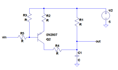

  • The current mirror is an interesting idea. I was going here with the following, it has good range but still very steep pulse width versus dac voltage over the linear range, plus it causes the LV123 to develop frequency dependencies.
    As long as I have decent resolution, range and response time, the micro's feedback control algorithm should take care of any calibration or temperature drift.
  • D'oh! Shows you how much I've forgotten about discrete design; that's much better. I should remember the presentation of BJTs in AoE, which starts with the transistor current source before developing all the other amplifier types.
    The one question I have is what's R4 for? R3/R5 scale the input voltage to Vdiv = (5 × R5 + Vin × R3)/(R5+R3) = 5 − (5 − Vin) × R3/(R3+R5), then we have the Q2/R2 voltage controlled current source, which holds the bottom of R2 at Vdiv + Vbe, so Q2's emitter current is 5 − Vdiv − Vbe = (5 − Vin) × R3/(R3+R5) − Vbe, and its collector current is beta/(beta+1) times that.
    This is all (to first order) independent of the collector voltage, so what does R4 give you? I suppose at high current levels it reduces Vce, reducing Q2's beta, increasing the base current required to hold R2 at the desired level, which causes Vdiv to float up, reducing the current. This basically flattens the short-delay part of the curve. But you want to stretch the curve at low currents, i.e. the high-delay range.
    I'd add a decoupling cap to Q2's base (ideally, time constant chosen to match your feedback loop update rate) and lose R4.
    Or, maybe you're about to make me go Do'h! with an obvious explanation of why I'm smoking crack...
