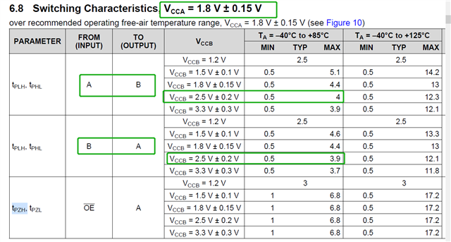

I want to use SN74AVC8T245 in my design, the requirements are copied below:
1) Transfer parallel data (16bits) from 1.8V to 2.5V,
2) data bus width is 10bits;
the timing is critical for my design, so the part to part skew is the key parameter, e.g., 1ns -2ns.
I found this in parameter in datasheet, 0.5-3.9ns, my question is:
1) is there any doc telling me the part to part skew?
2) For my case, the two SN74AVC8T245  will be powered by the same voltage, sharing almost the same load capacitance, what kind of skew will be?
