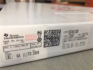

Hello, the following is the material test situation, please analyze the reason, thank you
Test conditions: add 77-110v dc voltage signals to 110VG (x1-dbz26) of 110VCS (q-1) using the regulated power supply. Indicators 1a-4b on the panel are on. When the voltage is lower than 60V, indicators 1a-4b is off
Abnormal situation: the 4A indicator light on the panel cannot be completely extinguished, and the voltage between the measuring chip and the ground is about 1V
1. Replace NXP brand materials and the fault disappears
2. Replace the samples provided by the original TI factory, and the fault disappears
3. Replace batch 2115 chips and the fault disappears
In addition: There is no problem that the two front screen prints are vertical lines. There is a small round pit in the front of the batch 2117+. Please see what is the difference

  • Description of fault phenomenon:
    When sbbak1 channel sends 110VDC, LD7 indicator light is on. After the 110VDC is removed, LD7 should be off, but actually LD7 is still on (brightness is halved), and the two pins of d8 are about 2.3V. The voltage of pin 1 is about 1V to the ground. Abba test is also abnormal for this channel.

    4. From the fault phenomenon, the chips in question are 2117 batches, and the silk screen logo is the one with a circle
