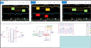

Hi Team,
My customer is using TXS0102 as I2C level shifter. For A2/B2 port, the behavior is ok, but there is an issue on A1/B1 port.
We checked the A1 signal is ok, but when we connect to TXS0102A1 pin the signal low level will be clamped. And the B1 output will also be clamped. Can you let me know if there is anything we can check?
