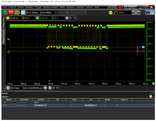

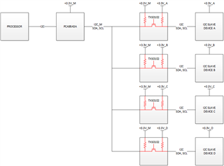

As shown in the block diagram below, four TXS0102s are used in one I2C line in the designed board. But there was an issue with the processor not reading the data properly.
So, when I checked the I2C line with the scope, I found that 0.5V is floating at the ground when the I2C SDA and SCL are low as shown below.

I have two questions here.
1. I wonder if there is any problem if I connect four TXS0102s to the same I2C lines as in our application.
2. If Master or Slave signal is made Low on i2c (SDA or SCL) line, all N2 channels inside TXS0102 (refer to the 3rd picture) will be closed, and the internal resistance of TXS0102 is all Parallel (10Kohm x 8) It seems to be connected to 1.25Kohm. The sink current will be 2.6mA. Can high sink current cause issue like this?
