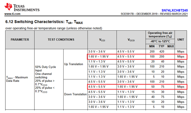

Hello team,
We have a customer interested in the conditions, where VCCI is 1.8V, VCCO is 5V and temperature is 25C. Do you have data rate values (inside red rectangles) available with 25C temperature? Thank you.
Carlo

Hello Clemens,
Thank you for your clarification on the data rate. Does it mean that Down/Up translation parameters don’t mean the direction of pulse edge, but rather the VCCI/VCCO voltage ”direction”?
Carlo
The VCCI/VCCO are different than actual pins VCCA/VCCB, so it means that for Down Translation only 50.75 MHz speed rate is guaranteed. What’s the guaranteed speed for Down Translation in 25C temperature? 50 MHz, 75 Mhz, or something between?
