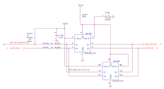

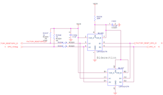

Dear team
There is a good news that we design in LSF0102DCTR in customer's new project.
Could you help to review the schematic?

Hey Denny,
Are they planning to have both device populated at the same time or are they just placing two footprints for supply reasons?
Hi Dylan
Thanks your reply.
Place two footprints for supply reason.
Many thanks
Denny
Hey Denny,
Thanks for confirming. Everything in the schematic looks good. I don't see pull-ups on the B side (they may be on another page?). They are not needed if the signals are only going in the B to A direction with push pull signals (it looks as though this may be the case).

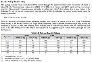

In case of signal going on both directions, for example UART communication, should we have pull up resistors on both side? which value is recommended?
As per datasheet I found below details. (In my application, I have UART going in between two controllers one is 1.8V and other is at 3.3V)
Hey Jigar,
So for UART, I actually recommend they use the SN74AXC2T245 device instead. Its more suited for that interface.
If they want to keep using LSF0102, I would have them add pull-ups on both sides to be safe. UART data rate is pretty low so they can likely get by with a 1k pull-up. Its most important for the TX or RX signal that will be shifted from 1.8 V to 3.3 V. These training videos on LSF will be a great help as well.
