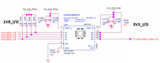

Does this mean if ANY of Vref_A OR Vref_B are at 0V then IO's will be in Hi-Z? datasheet says "When Vref_A, Vref_B = 0, all of data pins and EN pin are Hi-Z."
Does this device has VCC isolation feature or just partial power down?

  • Hi Clemens,
    Refer to the snapshot below,
    1V8 and 3V3 power rails will start at different times, one sooner than the other one and I want to make sure there won't be any back-drive from 1V8 side to 3V3 side or vice versa.
    Does LSF0204DRGYR partial power down mode can isolate the two domains or not?
    This chip per datasheet has partial power down mode feature not VCC isolation.

  • When the 3.3 V supply powers up first, a current can flow into the 1.8 V supply. (This current is limited by the internal 200 kΩ resistor.)
  • Hey Reza,
    This device does not have the VCC Isolation feature that allows one of the supplies to be powered and still keep the I/O disabled. For this device, both VrefA and VrefB have to be 0 V for the Ioff circuitry to be active.
    It looks like you are working with O.D. MDIO signals, it may be better for you to use two TXS0102 devices for this since it does have VCC Isolation and as long as one of the supplies is at 0 V, the I/O are disabled.
